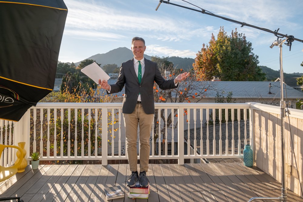

Here's an example. I did the A Roll / audio for this with the Samson C02 boomed overhead the talent in to the Tascam DR-60-D II. There is a LOT of work done on the audio (I basically had to run it through Adobe Podcaster as well as some EQ and other things in Resolve... don't remember exactly what.
The only B Roll I contributed was the parts where Marin County was NOT on fire or under water.
Aside from the (slight) wind noise (don't have a dead cat / blimp for these mics), we were about a block away from the local high school, and halfway through the shoot they had cheer leading practice, and so a dji was blasting music for them to practice to.
Here's a BTS shot that shows (more or less) the setup. Because my 300 Watt Godox light wasn't adding anything, I just changed out the softbox and light on camera left to a DIY scrim (just draped some translucent cloth over a background stand on camera left, then a white reflector for fill on camera right).
Note that the boom stand was a LOT closer to the talent at the time of shooting (probably around 18 inches or half-a-meter away for thsoe who don't speak Freedom Units). The talent requested this BTS photo after I had already moved the c-stand with the boom further away from the talent in order to strike the set.
On the tascam, I set the gain to medium (in the menu) and then crank the physical dial up, which seems to have slightly less noise than setting the gain to high (in the menu) and turning the phsyical dial down.
Let's not talk about the apple boxes :(

Why not use the exposed lav I can see on him? (which was the Tascam DR10L? btw, perhaps get this: https://www.bhphotovideo.com/c/product/1444316-REG/remote_audio_urs_furtangblk_ursa_tangle_cut.html , or even: https://www.bhphotovideo.com/c/product/885674-REG/auray_wlw_fuzzy_windbuster_for_lav.html or https://www.bhphotovideo.com/c/product/253753-REG/Rycote_065501_Furry_Windjammer_for_Lavalier.html )
No wind protection??? 😮
Ballsy!!! Just rocking it bare naked.
That should be #1 on your purchase list to get next.
Don't you still have the stock foam cover for the Samson mics?
Something like this, you could wrap around on top of the foam windscreen to give a lot of extra wind protection:
https://www.bhphotovideo.com/c/product/1551649-REG/auray_wsw_vmntg_custom_windbuster_for_rode.html
Alternatively, this here should fit the Samson C02 (they're both 20mm width):
https://www.bhphotovideo.com/c/product/1541174-REG/auray_wsw_vmicro_custom_windbuster_for_rode.html

Yikes!
But maybe if your mic had been a bit closer....
Phew! That BTS pic looked scary far away.
But even 50cm is rather far away.
Thanks for the detailed info you gave in your post, much better than people normally do when asking for feedback!
I'd say your priorities should be:
1) wind protection for your Samson CO2 mics, as this is super dirt cheap
2) upgrade your boom mic(s), getting first of all a shotgun (lots of choices! Some lower budget but high quality choices are: Rode NTG5, Sanken CSM1, DPA 2017, Audio Technica BP4073, & Deity SMic3. Get one or two), with wind protection (if the mic doesn't already come with it. Such as the Rycote Softie: https://www.bhphotovideo.com/c/product/207238-REG/Rycote_033052_Standard_Hole_Softie_Windscreen.html Making sure it's the right size for your mic of course!)
3) get a blimp for it for high wind situations
4) upgrade your boom mic(s) take two, getting now a hypercardioid microphone (or two... depending on your shooting needs/style), with wind protection for it too.
5) upgrade your Tascam DR10L to a Sony UWP-D21 or Deity THEOS, so that you can monitor your lav audio too. (send the boom mic to your left ear, and radio mic to your right ear, while recording both in your DR60D)
6) get a MixPre or Zoom F Series recorder
You can see upgrading the recorder is the very last thing on this list.
Just go through this plan step by step, as funds allow it.
Just realized you're not using a proper boom pole or any real shock mount either!! 😮 😮 😮
Near the top of the list (either just before getting a shotgun mic, or just after getting a shotgun mic) should be getting a shock mount and a real boom pole.
Such as one of these:
https://www.bhphotovideo.com/c/product/554999-REG/Rycote_041107_INV_7_InVision_Indoor_Microphone.html
https://www.bhphotovideo.com/c/product/880280-REG/Rycote_041118_INV_8_Microphone_Suspension.html
Or get a Radius shockmount (they're new company set up by the ex-Rycote people).
https://radiuswindshields.com/ (B&H is not stocking them yet)
Here is are dirt cheap Boom Poles you could get:
https://www.bhphotovideo.com/c/product/1384773-REG/airo_abp1_boom_pole_1.html
https://www.bhphotovideo.com/c/product/1601173-REG/proam_usa_boom_sq_10_telescopic_boom.html
https://www.bhphotovideo.com/c/product/1266050-REG/e_image_ba12_11_5_section_telescoping_aluminum.html
https://www.bhphotovideo.com/c/product/1666142-REG/digitalfoto_solution_limited_bm01c_carbon_fiber_microphone_boom.html
https://www.bhphotovideo.com/c/product/1374872-REG/came_tv_ms300c_carbon_fiber_microphone.html
https://www.bhphotovideo.com/c/product/1504170-REG/proaim_bp_12c_12_carbon_fiber_boom.html
Or spend a little bit more for:
https://www.bhphotovideo.com/c/product/326966-REG/K_Tek_KE_110_KE_110_Avalon_Series_Aluminum.html
https://www.bhphotovideo.com/c/product/625156-REG/K_Tek_KE_144_KE_144_Avalon_Series_Aluminum.html
https://www.bhphotovideo.com/c/product/1606022-REG/auray_bp_59a_5_section_aluminum_boom_pole.html
https://www.bhphotovideo.com/c/product/1773622-REG/k_tek_kc108_essential_5_section_boompole.html
https://www.bhphotovideo.com/c/product/1490197-REG/k_tek_kp9_klassicpro_graphite_6_section.html
https://www.bhphotovideo.com/c/product/1639167-REG/k_tek_kp10v_boom_pole_carbon_removable.html
https://www.gothamsound.com/product/qp-slim-short-quickpole-boom-pole (my personal choice here)
