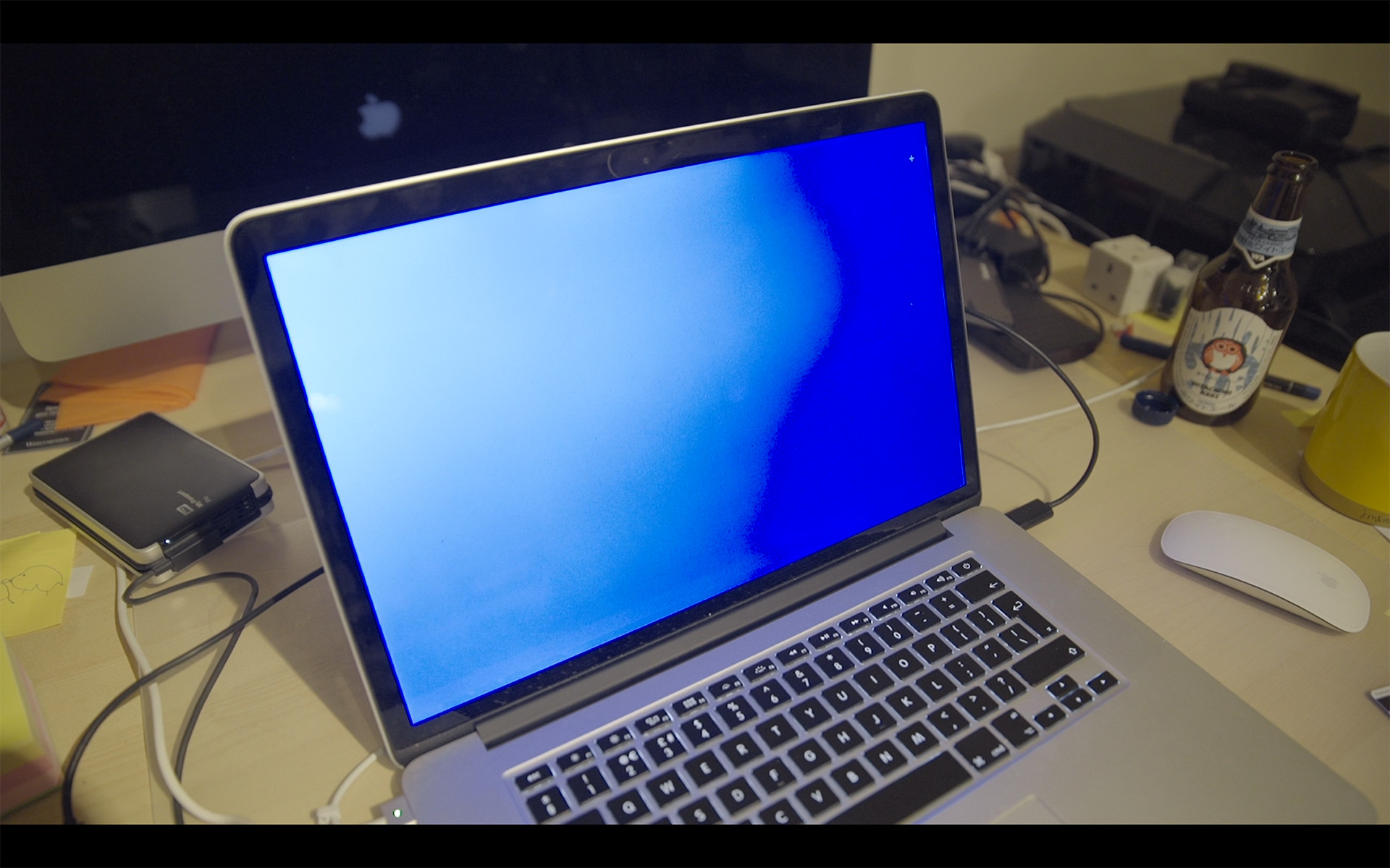

Administrators Andrew - EOSHD Posted January 3, 2015 Administrators Share Posted January 3, 2015 The problem I am having with the A7S is that - yes - colour can look lovely after a lot of work grading in post BUT and it's a bigger but than Beyonce's, you can't apply the same grade to every shot, every lighting circumstance needs it's own 2 hours of fiddling in Resolve. That for me is intolerable really. Also the bright-blues clipping issue is a problem, whenever I happen to have a blue light in the background of the shot I can no longer do what I want with the exposure, I have to "manage the problem" and it becomes tiresome.Still love the A7S, it's great for the price but I need colour that's quick to get right and internal 4K, it is not giving me either sadly. Link to comment Share on other sites More sharing options...

Administrators Andrew - EOSHD Posted January 3, 2015 Administrators Share Posted January 3, 2015 Not allowed to change your mind on the internet about cameras apparently 1D C CLOG:A7S SLOG 2:Not good is it?When I originally reviewed the A7S I loved the colour, from picking out the odd shot here and there.Afterwards I spent months developing my own LUTs in Resolve that I could blanket onto an entire sequence in Premiere.Didn't work because each scene / lighting needed their own nob fiddling. Link to comment Share on other sites More sharing options...

Guest Ebrahim Saadawi Posted January 3, 2015 Share Posted January 3, 2015 Afterwards I spent months developing my own LUTs in Resolve that I could blanket onto an entire sequence in Premiere.Didn't work because each scene / lighting needed their own nob fiddling.The ugly blue channel clipping showing it's face here!What a shame a company like Sony allows such a significant flaw in their sensor. I haven't been bitten by it however, yet.You frames here show the entire problem with the a7S colour science, blue clipping and yellow/green tint in the mids/lows, not just a tint, even some yellow "blotches".Look how the desk looks apparently red/magenta on the 1Dc while the a7s is rendering it as absolute yellowish green? That yellow tint is the core of the skin problem in the a7s.A typical Sony yellow skin is perfectly represented in the last frame posted by J.F.R above (Love the first shot btw) Link to comment Share on other sites More sharing options...
