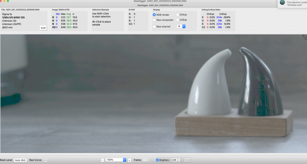

Just double checking but yeah, the green/magenta stuff is in the actual DNG itself. No question.
What's happening is perhaps a truncation issue converting between the 12 bit source and the 10 bit. The green values are rgb(0,1,1) so no red value. This is the very lowest stop of recorded light either 0 or 1
I think this is quite common because come to think of it he A7s always suffered green/magenta speckled noise - and that would make sense that the bottom two stops are truncating strongly and the with noise on top of it.
What sigma *ought* to do is to balance the bottom two stops and make the equal grey because the colour cast with a single different digit is quite high. This could be what ACES and BMDFilm is doing.
I still say it's a bug but if you go from having 16 values to describe a colour to 1 value then any kind of tint means that when it's truncated it will be made stronger. But i think i understand better why.
Also @Chris Whitten if you see the image stats you can see that the highest recorded value in that DNG is 648 and this is a 10 bit container so there are 400ish more values that could be recorded here. I know this is an under exposure test so this is why in this case!! (Not teaching you to suck eggs i hope!!! Certainly don't mean to come across like that)
RAWDigger is an awesome tool if you want to poke around inside DNGs!!! Highly recommended!!

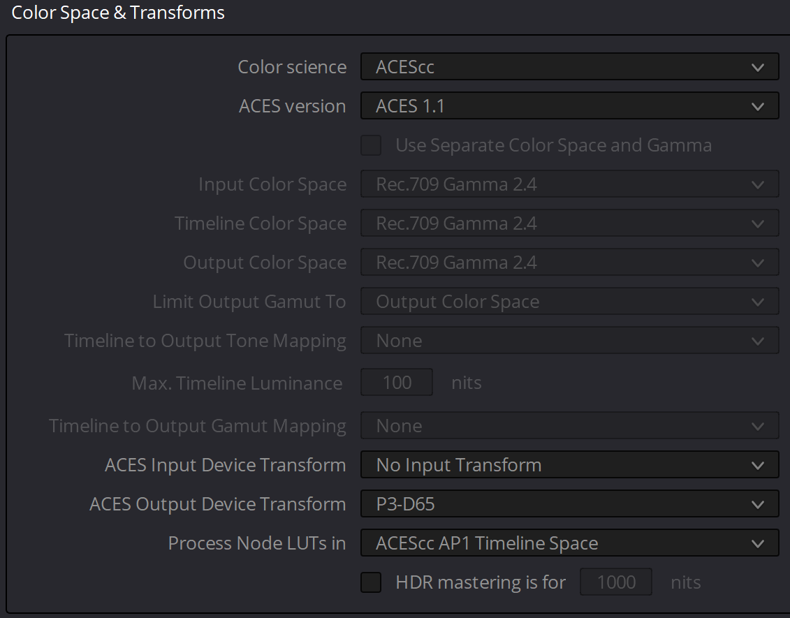

@redepicguy Attached are my current settings. I try to make the initial capture as solid as possible as far as exposure goes to avoid a lot of pushing or pulling in post. In the node chain for the start of a grade, I'll also add a Color Space Transform node to convert the ACES AP1 space down to P3-D65. Allows for more color depth than Rec709, but gives a more natural response with saturation and is supported on more and more devices these days. Also the gamma is a little softer rolling down into shadows which lets me see into darker areas without needing to bend the gamma or use lifts to see it. I try to use a global approach to getting a look in place of tweaking knobs if at all possible. Probably leftover habits of working with film for a while :)
You don't have to convert the colorspace from ACES AP1 to 709 or P3, but I find that AP1 needs to be saturated a LOT in order to feel normal, and pushing saturation can behave weirdly depending on the subject or scene. Using the conversion method adds what I think is a natural boost of color without needing to crank things crazily. Is any of this approach correct? I have no idea. But it seems to work well for the kind of images I like to capture.

@redepicguy Attached are my current settings. I try to make the initial capture as solid as possible as far as exposure goes to avoid a lot of pushing or pulling in post. In the node chain for the start of a grade, I'll also add a Colorspace Conversion node to convert the ACES AP1 space down to P3-D65. Allows for more color depth than Rec709, but gives a more natural response with saturation and is supported on more and more devices these days. Also the gamma is a little softer rolling down into shadows which lets me see into darker areas without needing to bend the gamma or use lifts to see it. I try to use a global approach to getting a look in place of tweaking knobs if at all possible. Probably leftover habits of working with film for a while :)

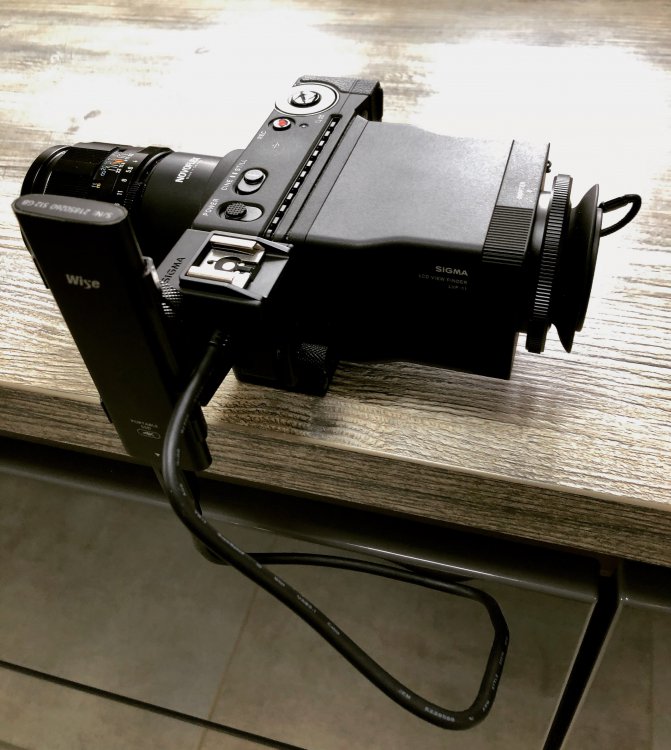

MOV looks to be very poor compared to the UHD modes. My rig is very small using the Wise portable SSD attached to Sigma's included hot shoe attachment.
Fair enough, but I'm using a Leica Elmarit-M 28/2.8 Asph, Voigtlander 35/2.5 and 40/1.2 VM as my main lenses, so - all due respect - your setup looks comparatively huge next to mine.
@Chris WhittenI think this is quite common because come to think of it he A7s always suffered green/magenta speckled noise - and that would make sense that the bottom two stops are truncating strongly and the with noise.
No doubt the EVF is massive and the biggest part of my set up. It is optional though, especially indoors.
The Wise SSD is very small and light. Apart from the Takumar lenses, which do require a large but light adapter, all my other lenses are very small vintage Leica M.
The UHD quality from the FP is outstanding. From what I've seen, the MOV files are worse than most decent cameras out there.
What are you viewing on?
If you're viewing on a modern apple device (MacBook, iMacs, iDevices) the P3 is the correct output colourspace for your monitors. If you view 709 on a P3 monitor then it will look overly saturated, conversely if you view P3 on a 709 display then it will look de saturate (the colours will also be off, reds will be more orange and so on)
Colour Management is a complicated subject and it can get confusing fast.
In theory you shouldn't be having to saturate images to make them look right. I have a feeling that perhaps there's something not set up quite right in your workflow.
Resolve can manage different displays, so it can separate the timeline colour space from the monitor space which is really important. On my main workstation i have a 5K GUI monitor which is 709 but a properly calibrated P3 display going through a decklink card. So i am managing two different monitor set ups.
So first you choose which timeline space you are working in. 709 is best for most cases, but if you have footage in P3, motion graphics in P3 or are targeting apples ecosystem then a P3 timeline can be helpful. P3 gives you access to teals and saturated colours that 709 cannot but *only* a P3 display could show you those.
The way you monitor is independent of your timeline. You could have two monitors plugged in, one it 709 and one is P3. Each of those monitors needs a conversion out (in Resolve settings). If your display is P3 and your timeline is 709 then a correct conversion to P3 is needed so you see the 709 colours properly saturated. If your timeline is P3 and you have a 709 broadcast monitor then that conversion has to do some gamut mapping or clipping to show the best version of P3 it can in a limited colour space.
This also applies to exporting images. The vast majority of jpeg stills are 709. The vast majority of video is 709. But apple will tag images and movies with display P3 when it can however universal support for playing these just isn't present,

@paulinventome I'm viewing and grading on a Dell UP2718Q which does 97% of P3 :)
I suppose what I'm reacting to is the AP1 color primaries versus P3's. P3 definitely reads as warmer with more pleasing hues out of the gate, but it's something I could dial in with AP1 with some knob tweaking if that would be more proper. Of course if I use the OneShot chart to start with, then even AP1 looks great since the colors have all been hue adjusted and saturated accordingly, so I may just need to embrace being a bit more hands on with the process. The joys of learning!
In theory, if the camera sees a macbeth chart under a light that it is white balanced for, at a decent exposure and you have the pipeline set up correctly - you should see what you saw in real life.
If you decide that the colours are wrong then, that's a creative choice of yours, but the aim is really to get what you saw in real life as a starting point then change things to how you like.
