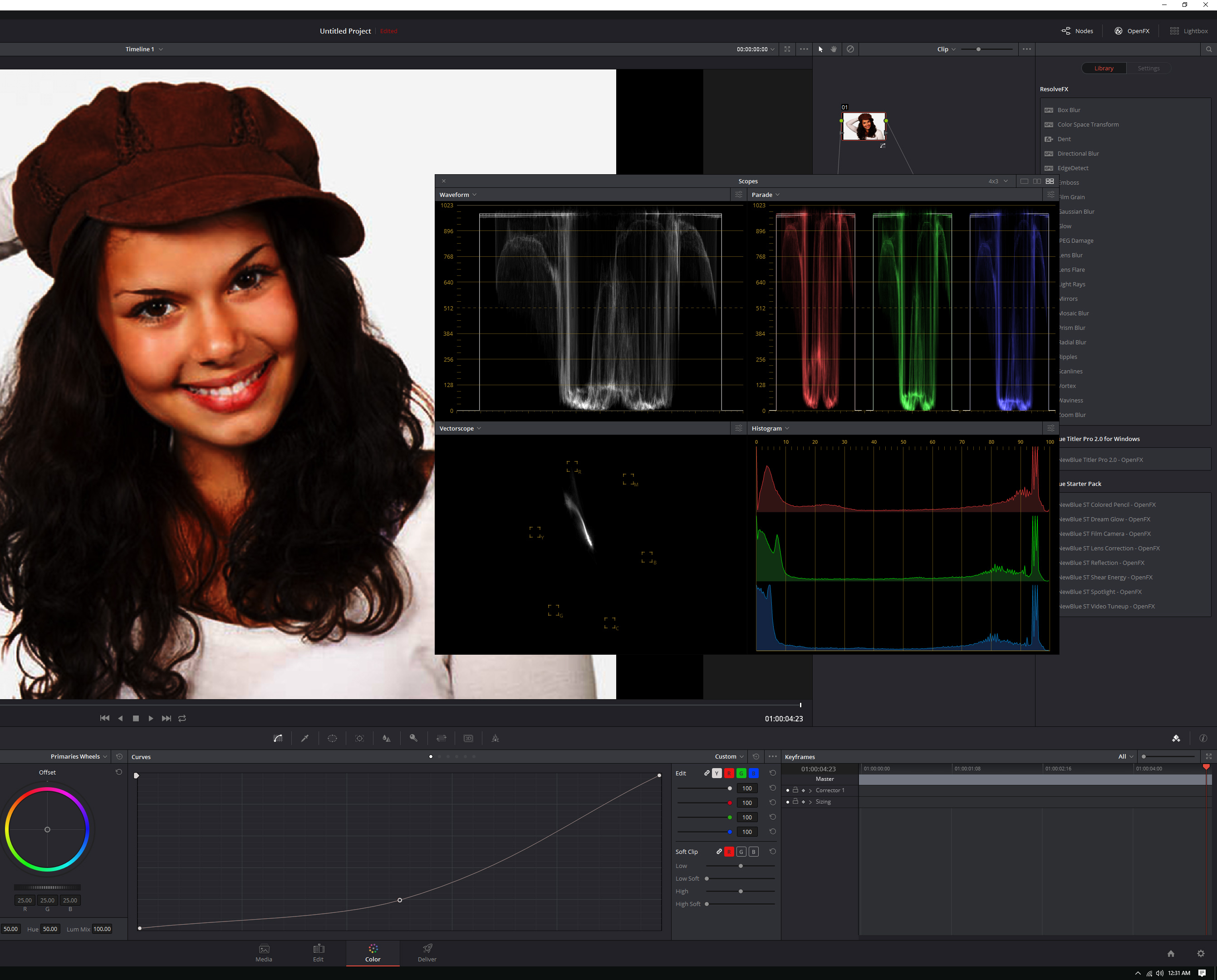

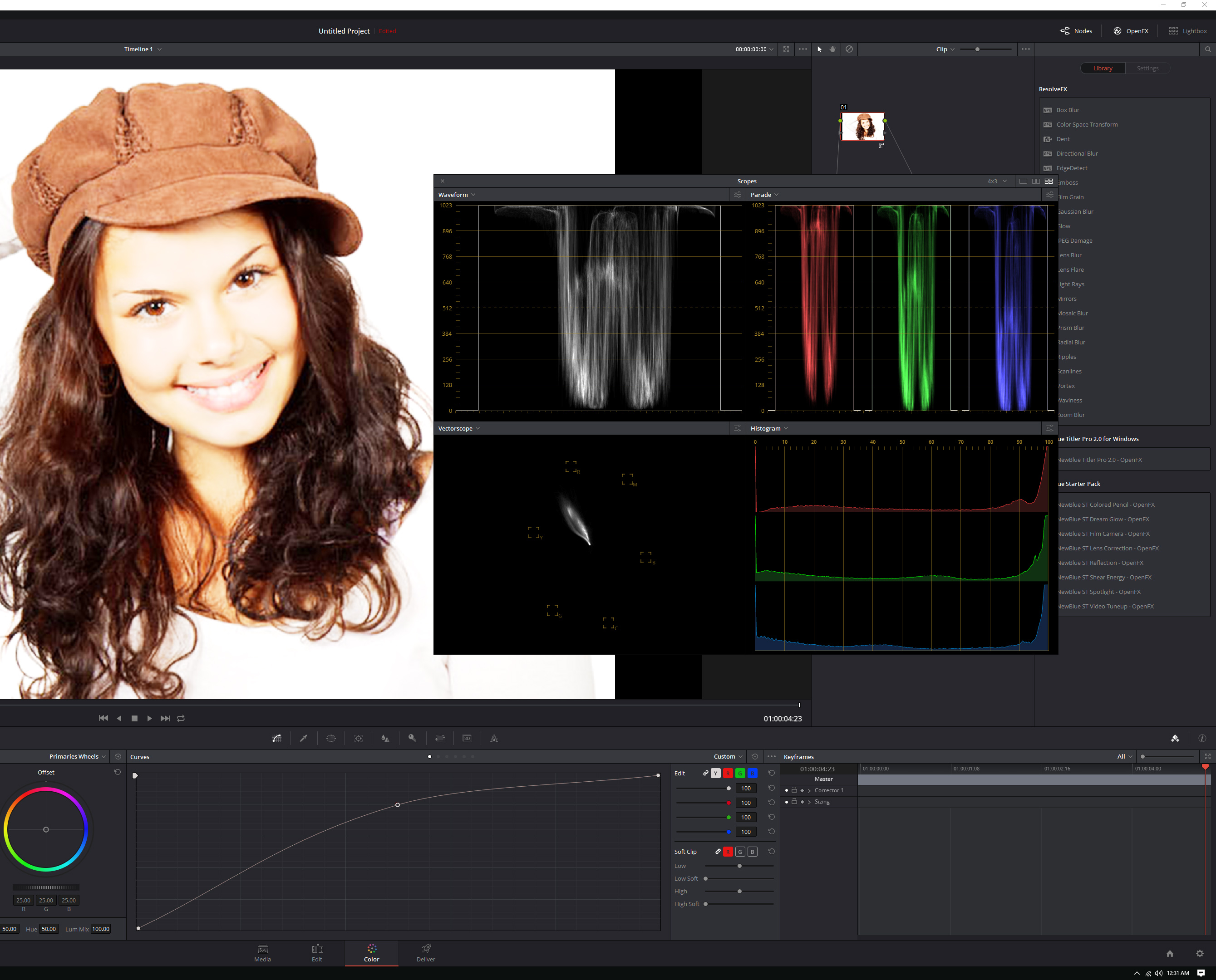

Don Kotlos Posted December 26, 2016 Share Posted December 26, 2016 http://menexmachina.blogspot.com/2018/07/skin-tones-with-premierefcpxresolve.html benymypony, Zak Forsman and Axel 3 Link to comment Share on other sites More sharing options...

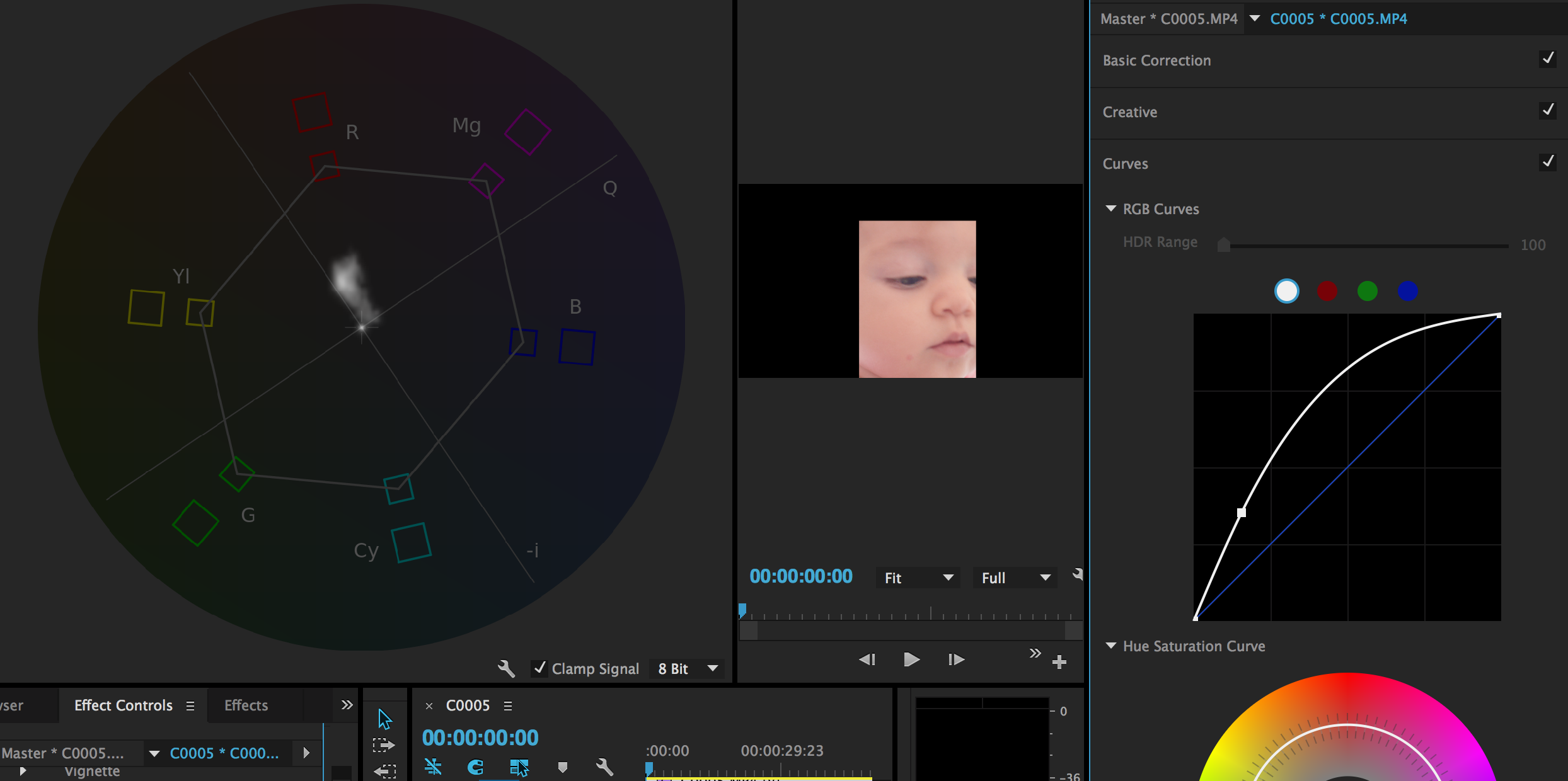

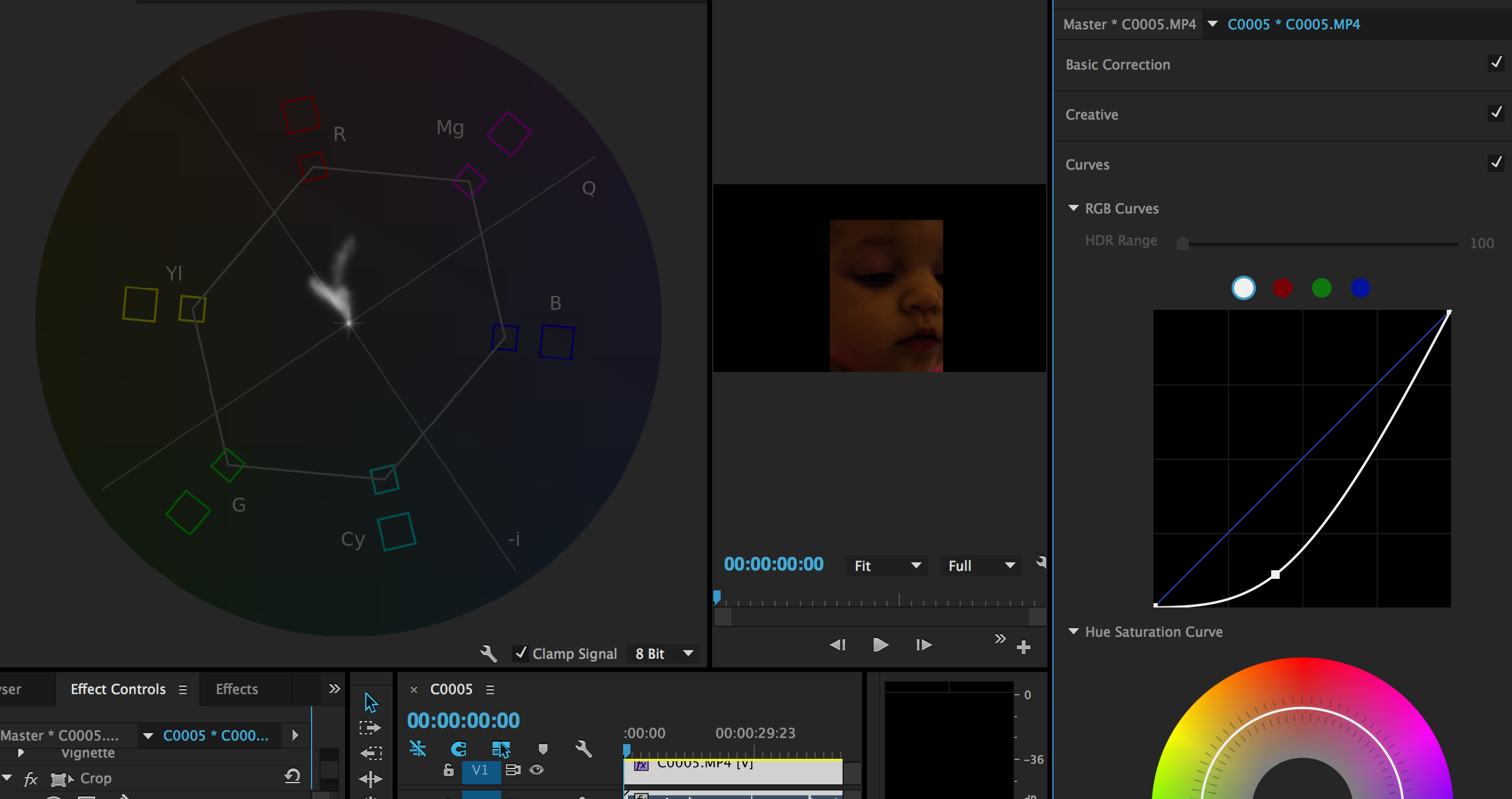

Don Kotlos Posted December 26, 2016 Author Share Posted December 26, 2016 16 minutes ago, Cary Knoop said: I partly agree and partly disagree. I agree that the Exposure slider in the Lumetri panel is not good (although I think things have improved somewhat in CC2017) and I would agree to generally avoid this slider altogether. I disagree with you about the Contrast slider. This slider is the classic s-curve and in my opinion works just fine! The Contrast slider in the Lumetri panel is very dissimilar to the Contrast from the Brightness & Contrast effect (or the ProcAmp effect), it fact it affects the dynamic range of an image not the contrast. I think the Curves in the Lumetri panel are just fine and operate as expected, I really do not understand on what grounds you base your criticism of Curves. Adjusting contrast with either the slider or the curves in Lumetri panel changes the hues of skin tones! Not the way it is expected to work at all. The effect is the same as with the exposure example that I have posted. If you compare it to the curves/contrast of Resolve it becomes really obvious. Link to comment Share on other sites More sharing options...
Cary Knoop Posted December 26, 2016 Share Posted December 26, 2016 4 minutes ago, Don Kotlos said: Adjusting contrast with either the slider or the curves in Lumetri panel changes the hues of skin tones! Not the way it is expected at all. I am sorry but that is simply not true, just watch the vector scope! Saturation (obviously) changes but hue does not! By the way, and you probably know this already, if you want to guard against saturation changes (although it can obviously not be totally prevented) you could do your modifications in an adjustment layer with a Luminosity blend mode. Link to comment Share on other sites More sharing options...

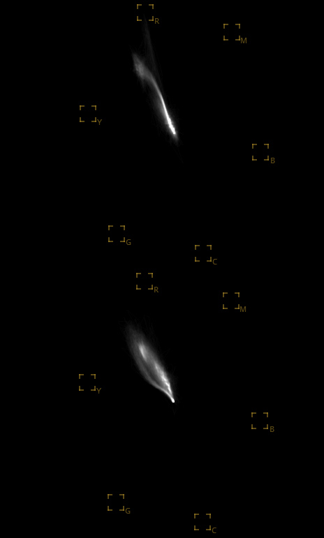

Don Kotlos Posted December 26, 2016 Author Share Posted December 26, 2016 3 minutes ago, Cary Knoop said: I am sorry but that is simply not true, just watch the vector scope! Saturation (obviously) changes but hue does not! It is true. Maybe its hard for you to see in this small size but the vector scope also shows a difference. Link to comment Share on other sites More sharing options...

Don Kotlos Posted December 26, 2016 Author Share Posted December 26, 2016 14 minutes ago, Cary Knoop said: Here is a video comparing the two NLE's. As you can see curves do not change hue both for Premiere Pro and Resolve. Here I made it easier for you to see: Link to comment Share on other sites More sharing options...

Don Kotlos Posted December 26, 2016 Author Share Posted December 26, 2016 2 minutes ago, Cary Knoop said: Going that extreme I would no longer define as color correcting, I think that is doing something very wrong with a video. But alright now please do the same extreme curves in Resolve. Now how did I know you are going to say this? I offer a subtle grade and you close your eyes, I make it extreme just so you can see and you don't like it because it does not agree with what you are claiming. If you actually look at the picture that I posted at the top you are going to see that Resolve does not change hue whereas Premiere with Lumetri color does. But its fine if you don't like the comparison (or the result), I am not going to argue with you any more. Maybe this thread is not for you, but for people that are (too) sensitive to differences in skin tones. mojo43 1 Link to comment Share on other sites More sharing options...
