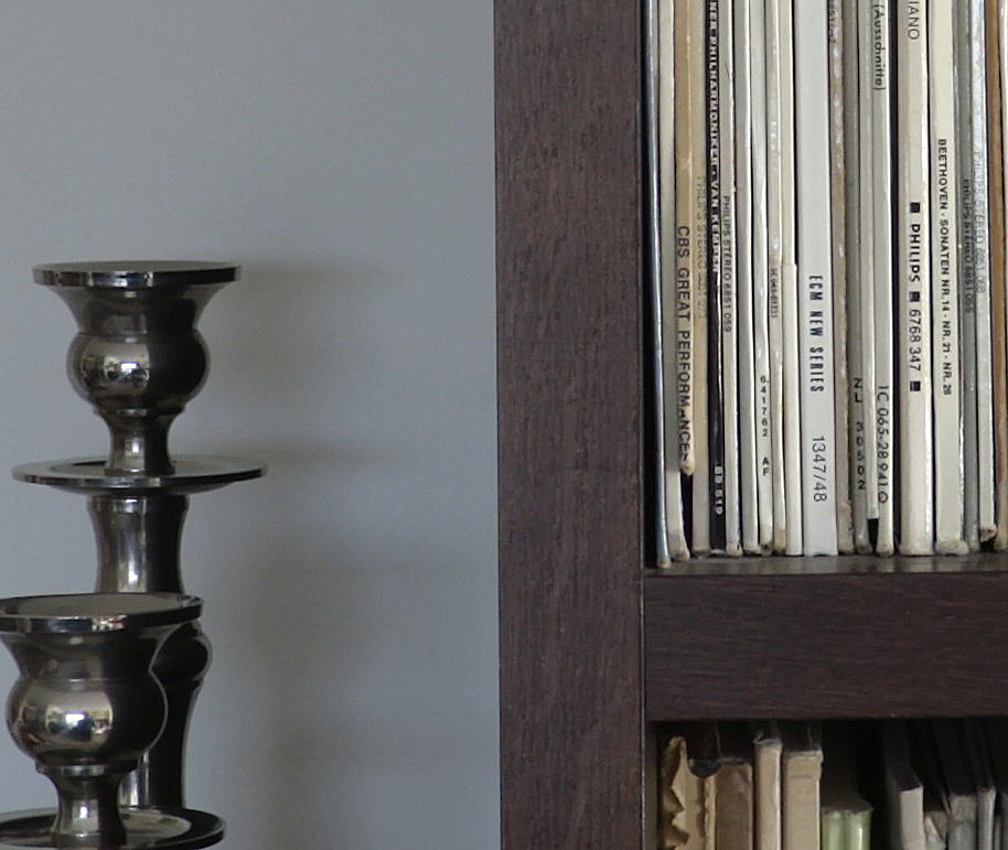

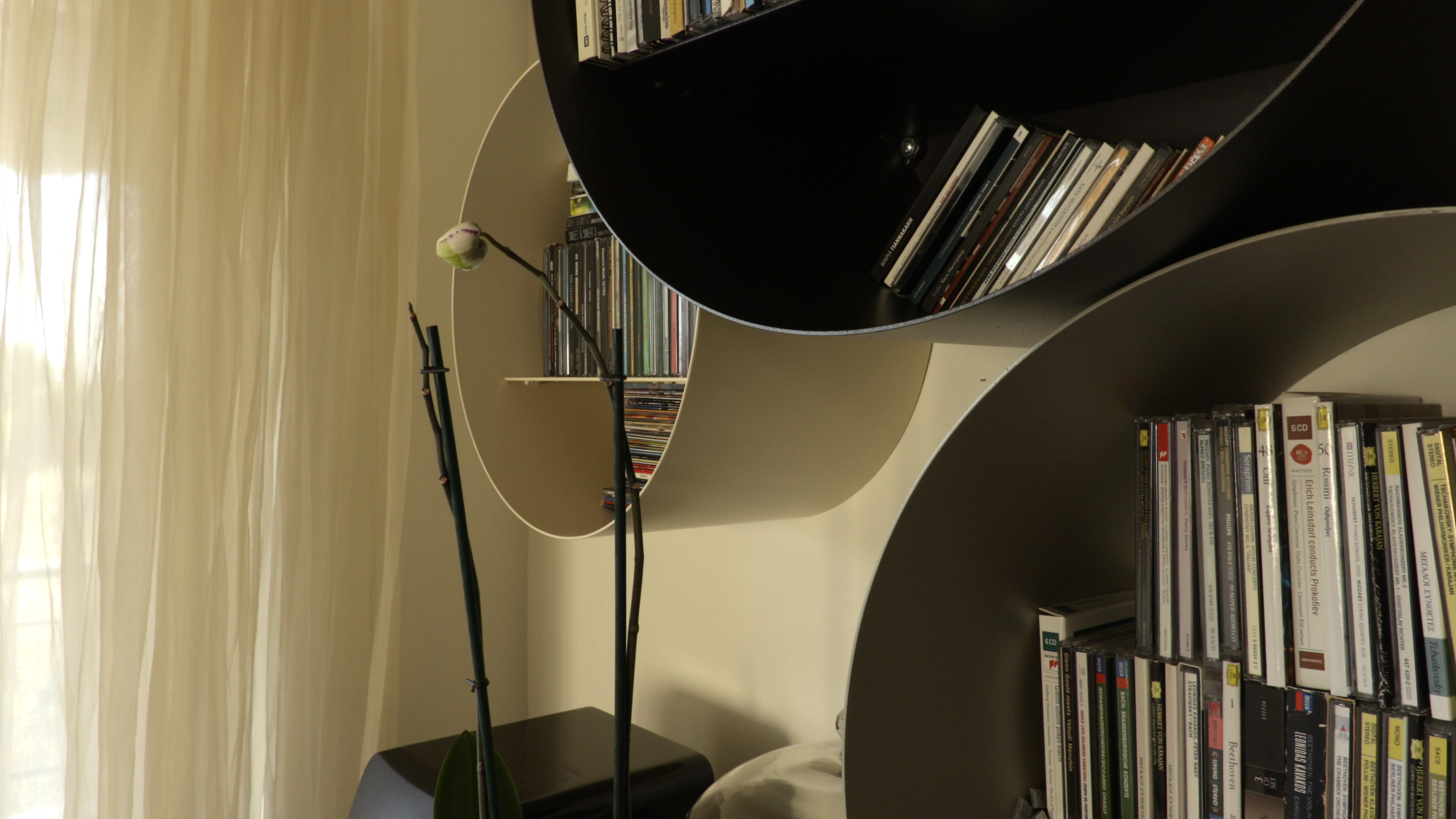

nikos 6 Posted February 27, 2016 Share Posted February 27, 2016 Reading EBU xc10 tests found that according to Alan Roberts measurements c-log has less resolution than look1 (standard look) Trying to test it in my xc10 I found that there is a loss in resolution going from standard profiles to c-log but also I found a weird "noise" in look1. c-log grab from davinci resolve 4k timeline (crop). look1 (standard) grab from davinci resolve 4k timeline (crop). resolution is better in look1 but is this "noise" acceptable? 4k 305mbp 500iso f5,6 25p(Pal) exposure a bit to the right. 4kclog_1.1.1.bmp Did a test with a bit more light. c-log 500iso f4 look1 500iso f4 Resolution is better in look1 but there is still "noise"... Any thoughts? Quote Link to post Share on other sites

nikos 6 Posted February 27, 2016 Author Share Posted February 27, 2016 Yes hmcindie, you are absolutely correct. The standard setting in look1 is sharpness +3. I changed it to 0 and the noise gone. Here is a new grab in Look1 with sharpness in 0. So now the real question. Why there is less resolution in c-log? Is this only in xc10? (haven't seen any comment about c100) Quote Link to post Share on other sites
