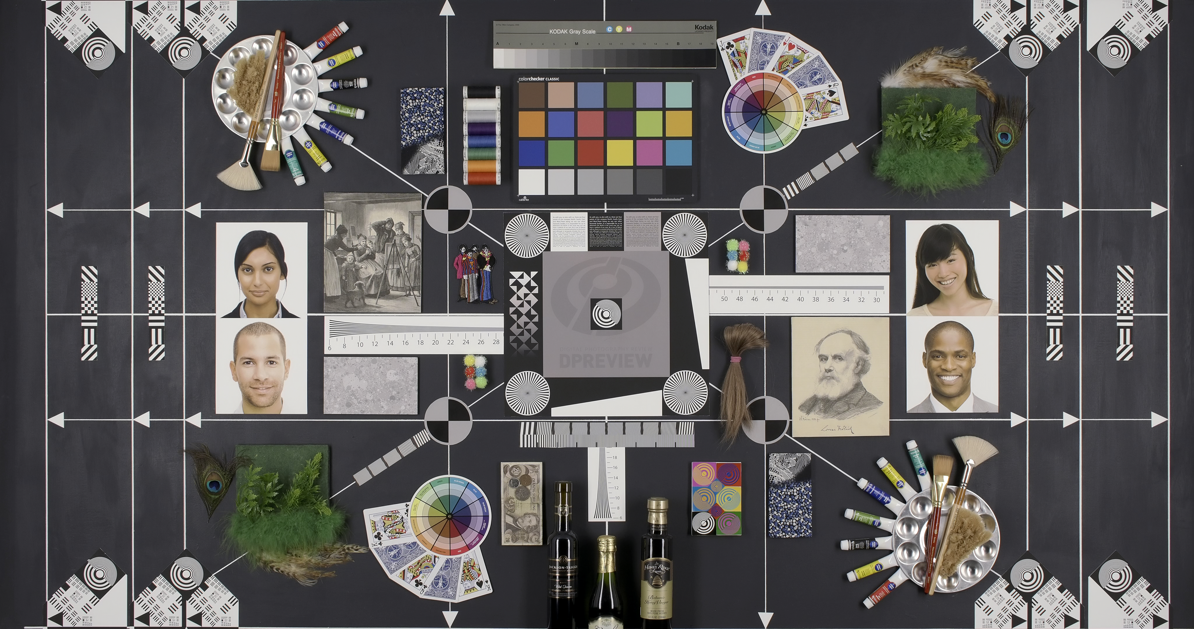

The 4k60p is not as detailed as 4k24/25/30p - see https://www.dpreview.com/reviews/image-comparison/fullscreen?attr29_0=omsystem_om1&attr29_1=omsystem_om1&attr72_0=4k_60&attr72_1=4k&attr421_0=10&attr421_1=10&normalization=full&widget=850&x=-0.3659681831889651&y=-0.46405799840375833
10-bit UHD or C4K at 24/25/30p are the most detailed modes. 50/60p is noticeably softer/less detailed. 10-bit also uses the (better) HEVC/H265 codec.

Great info @ac6000cw
As you can see from the DPReview OM-LOG400 test chart Olympus went for Bart Simpson 701 Space...
Big yellow-green shift in the reds and skintones.
So any LUT which addresses this before adding further grading would be a nice find.
