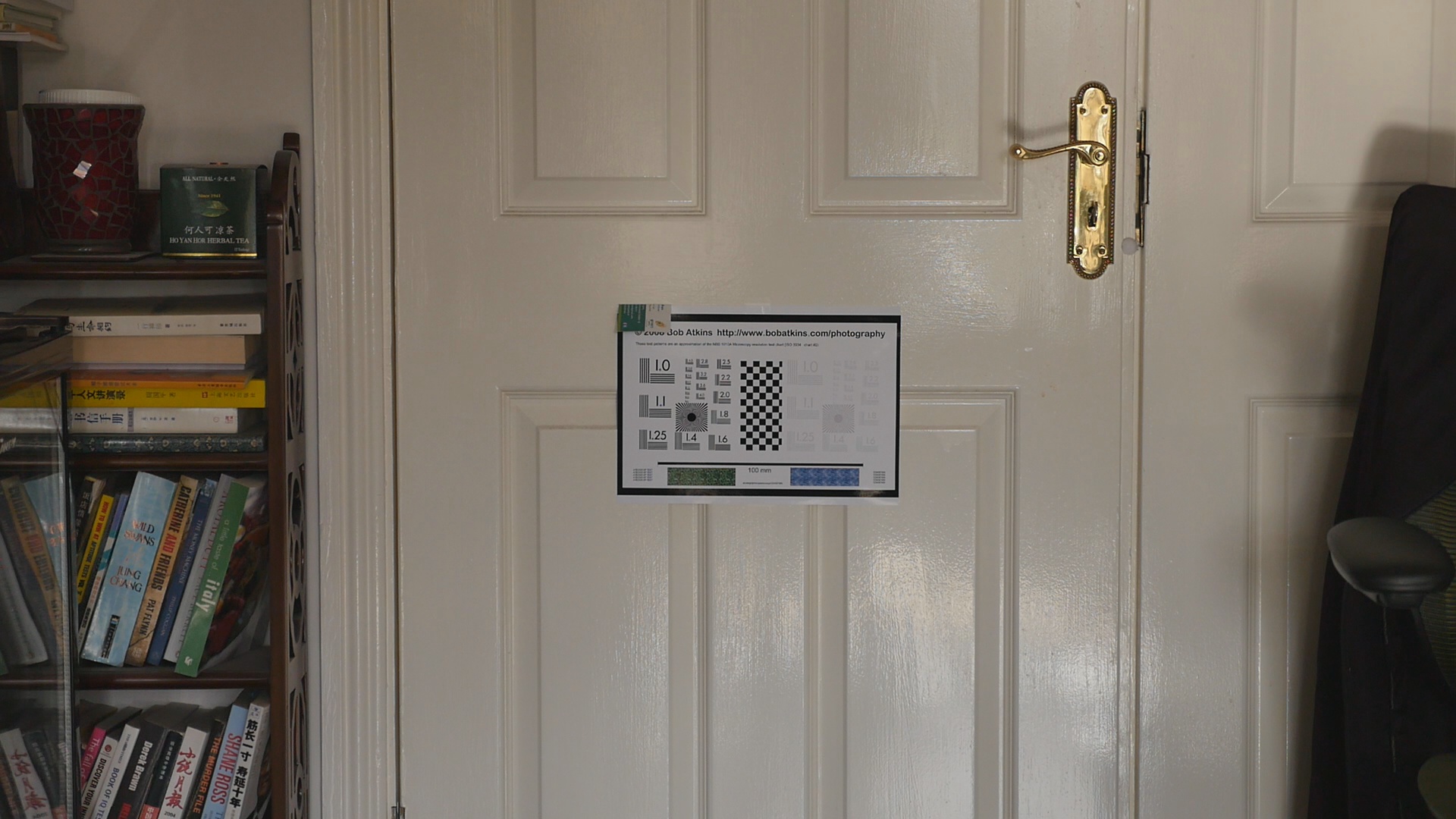

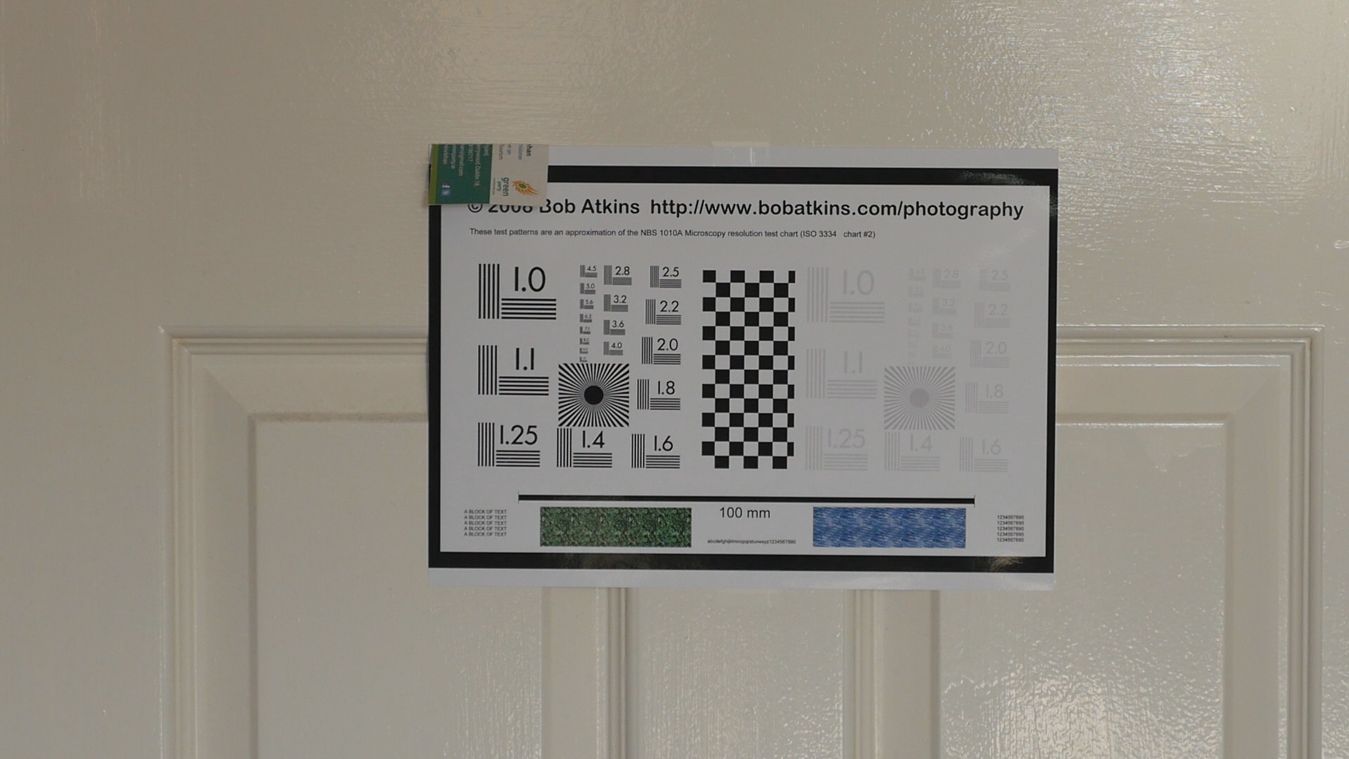

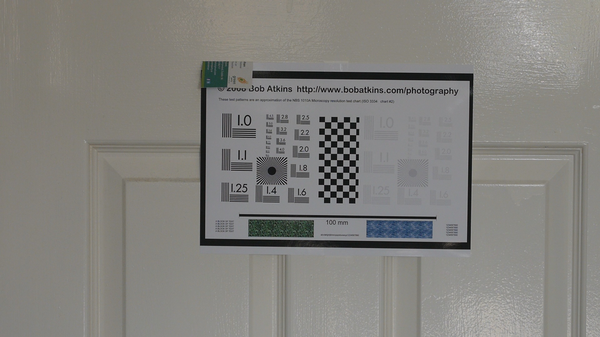

Don Kotlos Posted March 10, 2015 Share Posted March 10, 2015 Here is another E-M5ii sample that somebody uploaded on Vimeo. Somebody uploaded another example from the E-M5ii: Jimbo 1 Link to comment Share on other sites More sharing options...
DPC Posted March 10, 2015 Share Posted March 10, 2015 I'm not getting anything like that sharpness out of my camera. Link to comment Share on other sites More sharing options...
Don Kotlos Posted March 10, 2015 Share Posted March 10, 2015 I'm not getting anything like that sharpness out of my camera.This is similar to the sharpness that I get too, and that is why I was so surprised with Andrew's take on the camera. Either is the settings that can really affect the quality or there is a bad batch of cameras. Link to comment Share on other sites More sharing options...
DPC Posted March 10, 2015 Share Posted March 10, 2015 What settings are you using? I've been using various variants of the Natural Picture Mode. Link to comment Share on other sites More sharing options...
Don Kotlos Posted March 10, 2015 Share Posted March 10, 2015 I am going around the settings that I showed with the towel example: Contrast:-2 Sharpness:0 Saturation:-1 . From the curves a step decrease of the whites, a step increase of the blacks. That is in All-I 24p 1/50 and with the 17mm f1/8. I am trying to find out what settings that guy used for that test. Edit: Apparently he used the natural profile: (Contrast, Sharpness, Saturation ALL set to '0'). Thanks for asking him too ;). Maybe the lens is also affecting the quality? So could it also be that with Olympus lenses there is some kind of compensation that manual lenses don't get? Link to comment Share on other sites More sharing options...
DPC Posted March 10, 2015 Share Posted March 10, 2015 I asked that. Natural with everything set to 0. What's interesting is that you are both using 24P and I'm using 25P. I wonder if that could make a difference? Link to comment Share on other sites More sharing options...
