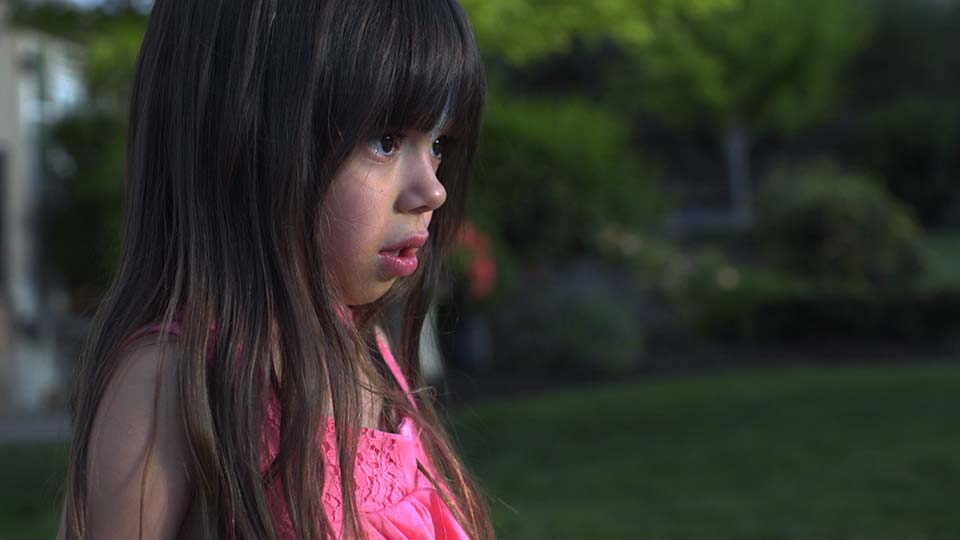

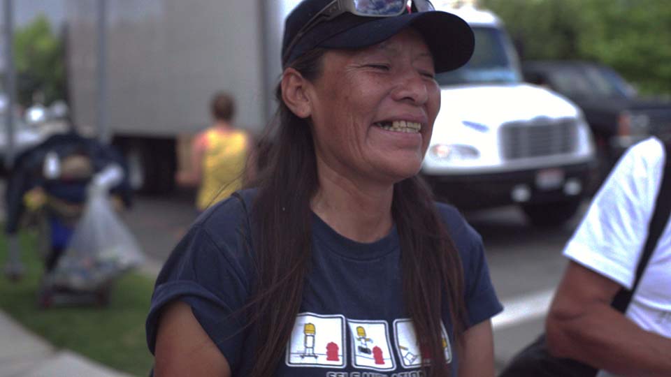

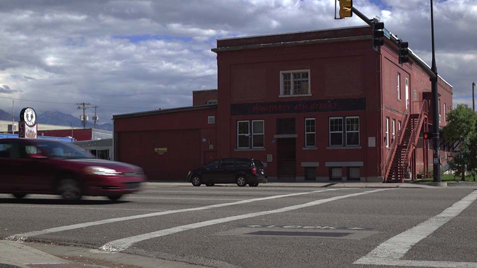

That is it, so far this looks really promising but would like to hear how it works out for the rest of you. I am adding some corrected still from Roman Legion as well. These images are ungraded I only converted to Rec709 and adjusted exposure as they were under exposed a little.
post-33074-0-57081200-1411162616_thumb.j
post-33074-0-64271600-1411162617_thumb.j
post-33074-0-01643200-1411162617_thumb.j
The example images look pretty good!

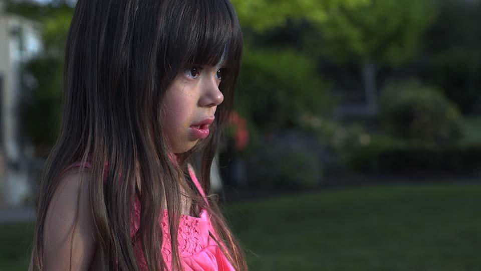

For final color grading of our first narrative, a Sci-Fi short called Delta, I calibrated 3 different displays with an X-Rite i1Display Pro (working on both Win7 and OSX). Two of the displays were Dells (2405 and 3007) with CFL backlighting and a Samsung D8000 HDTV with white LED backlighting. Even after repeated calibration, the displays weren't exactly the same, however color behavior was fairly close. I also checked color on uncalibrated MacBooks Pros, iPhones, and iPads. This is something I did with videogame development- testing on a wide variety of hardware to see how the product performs. Each display is different, and many times one of the displays would show something the others did not, requiring a grading adjustment. Most end-user displays aren't calibrated: this kind of testing is helpful in making sure the final product looks good in most conditions.
In my experience with recent Sony cameras (FS700 and A7S), Sony's sensor+software are 'unstable' around skintones. The color swings around magenta and green, making accurate and good looking skintones much trickier than with Panasonic or Canon. Even when skintones are 'correct' using the vectorscope, they don't always look correct with the naked eye. In other words, good looking skintones for Sony cameras have a small sweet spot, like the peak of a pointed parabola, with magenta on one side and green on the other. Panasonic goes green / orange with a more rounded parabola (more good skintone range), and Canon goes slightly-green / orange with the flattest parabola- the best skintone range with the least amount of post work.
I shot the first scenes of Delta with the A7S using stock PP6 (Cine 2 and Cinema Color Mode) outdoors with rapidly varying lighting conditions using auto ISO and AWB. In post I found the best skintones, especially for scenes of an alien planet, had a magenta bias:
The magenta bias helped set the mood for an alien world.
For the first Earth scene, I used PP7 with Slog2 and Pro Color Mode (essentially Kholi's settings with minor tweaks). The main shot used for this prototype poster is from a 1080p frame grab from the film:
The bottom images are GH4 with Natural profile from green screen studio shots. The wall image was shot on the A7S as a background plate during sunset on location.
Interestingly, scene to scene color variance was never mentioned during early screenings. While the current version matches more closely, it's not perfect and in the end the goal is for the color to affect emotion and scene energy more than perfect color matching. Note the character on the lower right has a magenta bias. When correcting for the white clothing, the skin ends up too green. The time-consuming fix is masking and correcting separately (I'll fix the colors for the final poster).
