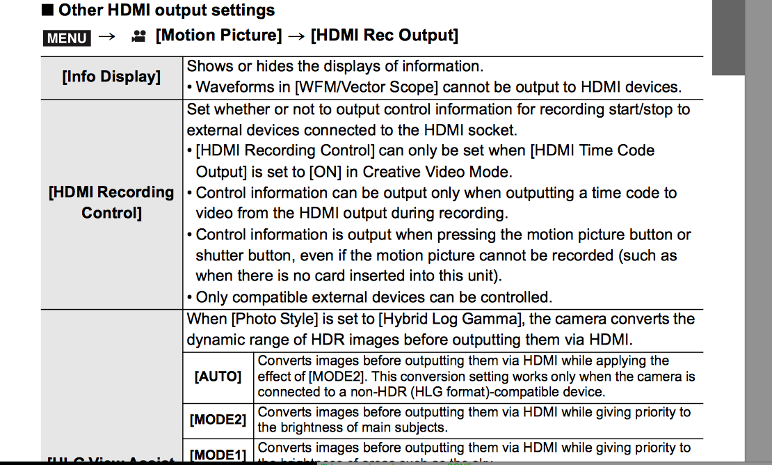

The Ninja V will start recording when it gets the control code from the GH5s through the HDMI port so you should be able to put the GH5s into record using your Ronin and the Ninja V will follow suit as soon as it picks up the code.
According to the GH5s manual, this will happen regardless of whether you have a card in the camera.
I have the Ninja V but not a GH5s so you should double check this with someone who has the combo or at least confirm it with Panasonic and/or Atomos.
41012274_ScreenShot2020-03-12at22_49_57.thumb.png.6778c04ed6c12e47bf08745f0372637a.png
