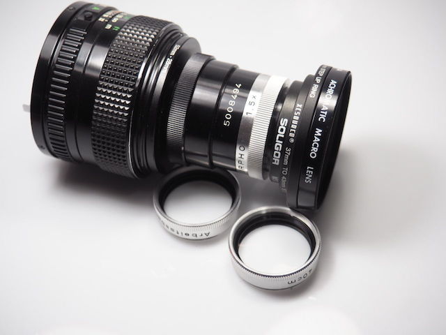

PepperJay Posted July 25, 2016 Share Posted July 25, 2016 Hi, folks, this is my first post here, so please forgive my ignorance (but feel free to point it out!). Anyway, so I'm a newbie to the anamorphic DSLR world, but I've been doing my research here and on YouTube, et al., and a recent purchase in particular has left me completely desperate for any helpful advice: I just bought the Isco mentioned above, but can't seem to draw a focus to save my life. The model in particular looks great cosmetically inside and out, but unlike a few other 8mm anamorphics I have, nothing I attach it to renders a usable image. From what I read, this is a focus through (no, couldn't afford the actual Iscomorphot), but none of my lenses within the 50mm range (Helios 44, Canon/Nikkor/Minolta 50's) have had any luck, no matter how much I stop it down (f8-22), and for any distance between 1m and all the way across the street. Seriously, I'm stumped. I'll attach a few photos of grabs I got during my checking about, but neither of these setups (ballpark from this end) seem to work. If it helps any (description-wise), the farther I hold it from my eye, the clearer the rear image is (albeit reversed)--and while this probably makes me sound like a complete dweeb, as I said, I'm desperate!!! Right, so I know most of us don't repair lenses for a living, but I guess what I'm hoping for is advice/opinions/directions from anyone with prior experience with these or similar lenses. It doesn't seem like there's any internal focusing issues or element separation, but at this point I wouldn't be surprised if someone put a curse on it (or me). Thanks in advance for any future help and for all the help you've provided so far by being available for those of us on the outside looking in. -Jason Note: the first to pics are the ones I modeled my setups toward, the 3rd is the lens in question, with some focus (at literal arm's length)... Ā Ā Link to comment Share on other sites More sharing options...

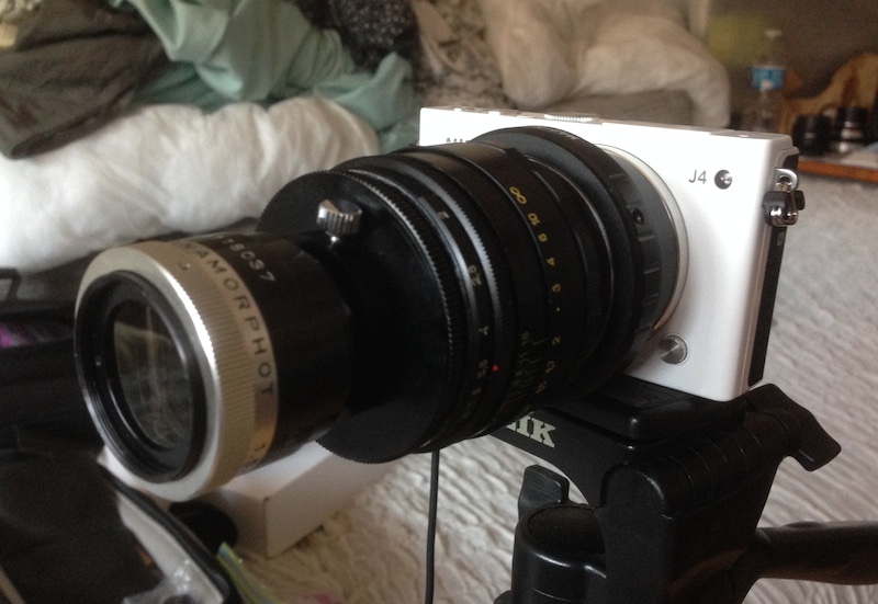

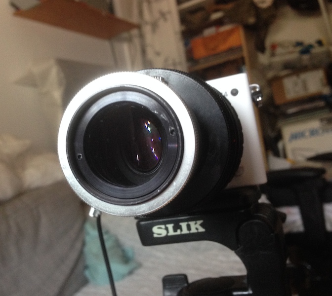

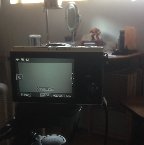

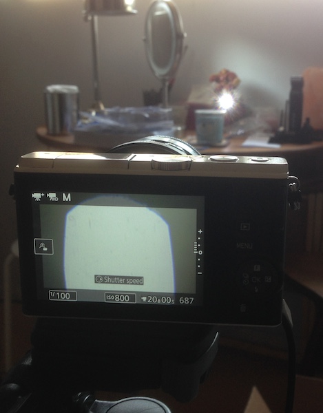

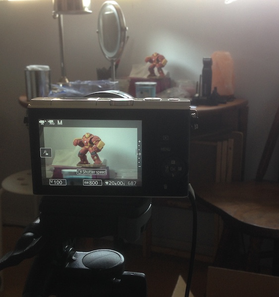

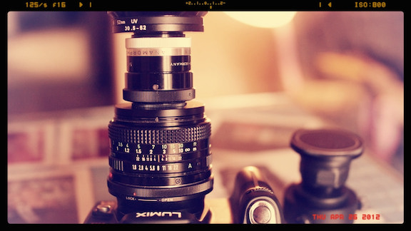

PepperJay Posted July 29, 2016 Author Share Posted July 29, 2016 Hey, Bioskop.Inc, so no joy over here. I set up my Helios 44, got nice focus, then mounted the Isco (pic#1). That blob in the 2nd was all I could get with my keychain flashlight at the same focal point, with no flares to work with, but vertial oval (both ways) in the front. The 3rd and 4th show the rig--just trying to get a clean image from 5ft. The last pic had the light off, making no change at all to the Helios from original settings. I've put +.25, +.50, +.75, +1, +2, +4 and +10 close up lenses and diopters in front yet to no avail. The other day, I tried with my 5DMKII, Canon 50mm and my Tamron 28-75mm. Same outcome @ approximately the same distance (the TV). As in the first post with the pic pointed at my TV, the only way I can get a distinguishable picture is when I hold it 2 feet away from my eye, and only then with a mirrored image. Anything closer or with any lens just causes me to question my manhood. :DĀ :| That said, I really appreciate your help thus far. I sent an email to the ebay dealer yesterday requesting a return, but (perhaps not surprisingly) haven't heard back. Not too worried because at this point I think I'd rather face opening a case than dealing with this little beast. Ā Link to comment Share on other sites More sharing options...
tweak Posted July 30, 2016 Share Posted July 30, 2016 11 hours ago, Bioskop.Inc said: Yeah the focus through thing is one of those myths/lies that circulates - with these 8mm attachments, it's just wishful thinking. The Iscomorphot S8/x2, which is also fixed focus & it doesn't really play well with racking. But having said that, I've also got the Isco Widescreen 2000 & in order to rack with that you need a diopter +0.5/0.25 (a weak one) and then stop down the taking lens a little - worth a try if you've got the right diopter. Good luck True, none of them are really "focus through", but you should be able to get some half decent focus stopped right down (which he says he can't). This I find strange. PepperJay 1 Link to comment Share on other sites More sharing options...
Bioskop.Inc Posted July 30, 2016 Share Posted July 30, 2016 11 hours ago, PepperJay said: Hey, Bioskop.Inc, so no joy over here. I set up my Helios 44, got nice focus, then mounted the Isco (pic#1). That blob in the 2nd was all I could get with my keychain flashlight at the same focal point, with no flares to work with, but vertial oval (both ways) in the front. The 3rd and 4th show the rig--just trying to get a clean image from 5ft. The last pic had the light off, making no change at all to the Helios from original settings. I've put +.25, +.50, +.75, +1, +2, +4 and +10 close up lenses and diopters in front yet to no avail. The other day, I tried with my 5DMKII, Canon 50mm and my Tamron 28-75mm. Same outcome @ approximately the same distance (the TV). As in the first post with the pic pointed at my TV, the only way I can get a distinguishable picture is when I hold it 2 feet away from my eye, and only then with a mirrored image. Anything closer or with any lens just causes me to question my manhood. :DĀ :| That said, I really appreciate your help thus far. I sent an email to the ebay dealer yesterday requesting a return, but (perhaps not surprisingly) haven't heard back. Not too worried because at this point I think I'd rather face opening a case than dealing with this little beast. That is strange. But looking at the second picture, i would say that you are too close to the TV - so perhaps the minimum is 5m not 5 feet. The light source shouldn't be covering the whole frame. The last pic looks like you're aimed at the wall. The Iscomorphot S8/x2 has a minimum of distance of 4/5m & the Widescreen 2000 is 5m - so it might be worth trying to focus at something further away. 5m is quite a distance & I had real trouble with this distance in my front room, so it took me a while to get things to focus. On a 5d2, you'll need something over 75mm. On APS-C or below a 50mm should be fine. If not try to contact QuickHitRecord - he's a really nice guy & might be able to point you in the right direction. Experiment - remember to adjust the taking lens, as sometimes the distances on these things aren't that accurate. Ā PepperJay 1 Link to comment Share on other sites More sharing options...
