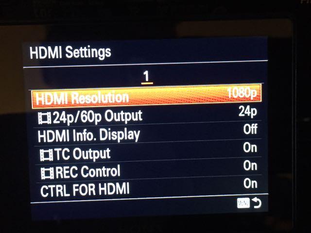

Don Kotlos Posted September 24, 2015 Share Posted September 24, 2015 On 9/24/2015 at 6:01 PM, Ebrahim Saadawi said: To get 60p you need two things, first is the camera to have a camera outputting a 60p HDMI signal, and to have a recorder that can record a 60p signal. Neither the A7 series outputs 60p nor the ninja records 60p. In fact, very, very view cameras output a 60p signal through HDMI, the only one I can remember is the Canon C100 MKII, and the only recorders that accept a 60p signal are the -Atomos Assassin/Shogun, -the Odyssey Q7+ (both 4K recorders)For 60p you'll have to go with internal recording for a while, High frame rate external recording is only available through HD-SDI on select cameras (Cion, C500, URSA, URSA Mini, FS700, FS7, F5) On 9/24/2015 at 6:29 PM, BrorSvensson said: Oh that sucks, but thanks for the great info!I am pretty sure that A7 does output 60p. Also from their advertising:"Capture Full 1920 x 1080 HD uncompressed clean-screen video files with external recording devices via an HDMI connection in 60p and 60i frame rates. Selectable in-camera AVCHD codec frame rates include super-smooth 60p, standard 60i or cinematic 24p, while MP4 codec is also available for smaller files for easier upload to the web." BrorSvensson 1 Link to comment Share on other sites More sharing options...
Guest Ebrahim Saadawi Posted September 24, 2015 Share Posted September 24, 2015 You're correct my bad, it's a great and quite rare feature so it's a shame the feature can't be exploited without a 2000$-ish recorder.How about the a7s? Does it output 60p too? in s35 and/or FF? Link to comment Share on other sites More sharing options...
aldolega Posted September 24, 2015 Share Posted September 24, 2015 I believe the GH4 also outputs 60p. And once the VA is out you won't need a $2000 recorder to capture it. Link to comment Share on other sites More sharing options...
