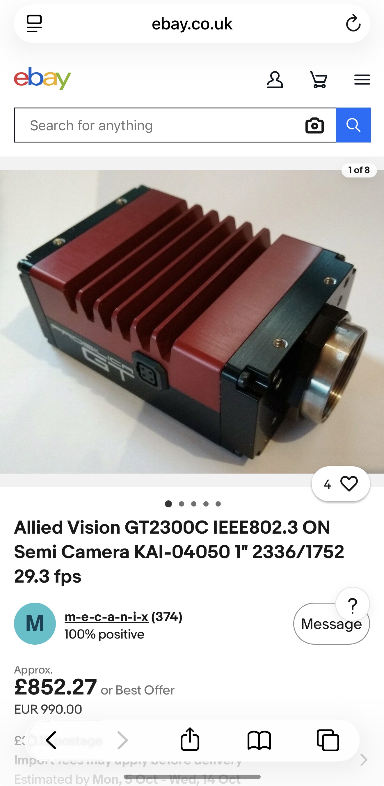

Super Members BTM_Pix Posted September 25 Super Members Share Posted September 25 For anyone looking to do something similar a suitable harvesting product is this Allied Vision industrial camera that uses the same Kodak CCD. They are also long since defunct of course but are available on eBay. https://www.ebay.co.uk/itm/284133056331 I think the price seemingly on the high side is probably reflective of people looking to do a DIY Digital Bolex too but when you consider that a used D16 is not easy to come by and is well north of £5K then for someone determined enough this route is something of a relative bargain. Pi 5 and its eco-system have now matured sufficiently to be able to handle the Allied Vision software in the intervening years so it’s definitely viable as a DIY project. Not trivial of course but viable. Andrew - EOSHD and eatstoomuchjam 2 Link to comment Share on other sites More sharing options...
Clark Nikolai Posted September 26 Author Share Posted September 26 11 hours ago, BTM_Pix said: For anyone looking to do something similar a suitable harvesting product is this Allied Vision industrial camera that uses the same Kodak CCD. They are also long since defunct of course but are available on eBay. https://www.ebay.co.uk/itm/284133056331 I think the price seemingly on the high side is probably reflective of people looking to do a DIY Digital Bolex too but when you consider that a used D16 is not easy to come by and is well north of £5K then for someone determined enough this route is something of a relative bargain. Pi 5 and its eco-system have now matured sufficiently to be able to handle the Allied Vision software in the intervening years so it’s definitely viable as a DIY project. Not trivial of course but viable. Yeah, they're not cheap even though they're only 2K and getting almost 15 years old or older now. The monochrome ones (using the same chip) are much cheaper meaning it could be worth it to roll your own monochrome cinema camera for those times when shooting black and white. Link to comment Share on other sites More sharing options...

Administrators Andrew - EOSHD Posted September 26 Administrators Share Posted September 26 On 9/25/2026 at 5:33 PM, BTM_Pix said: For anyone looking to do something similar a suitable harvesting product is this Allied Vision industrial camera that uses the same Kodak CCD. They are also long since defunct of course but are available on eBay. https://www.ebay.co.uk/itm/284133056331 I think the price seemingly on the high side is probably reflective of people looking to do a DIY Digital Bolex too but when you consider that a used D16 is not easy to come by and is well north of £5K then for someone determined enough this route is something of a relative bargain. Pi 5 and its eco-system have now matured sufficiently to be able to handle the Allied Vision software in the intervening years so it’s definitely viable as a DIY project. Not trivial of course but viable. Very tempting. Do I read this correct... 4/3rds CCD?? https://www.ebay.de/itm/275742776320 Ah no 4/3 inch These are cheap... https://www.ebay.de/itm/157847196101 The hunt for machine vision cameras is officially on 🙂 Link to comment Share on other sites More sharing options...

Clark Nikolai Posted September 27 Author Share Posted September 27 17 hours ago, Andrew - EOSHD said: Very tempting. Do I read this correct... 4/3rds CCD?? https://www.ebay.de/itm/275742776320 Ah no 4/3 inch These are cheap... https://www.ebay.de/itm/157847196101 The hunt for machine vision cameras is officially on 🙂 Of these only the Allied Vision Prosilica GT 3300 has the KAI-08050 sensor that the DB used. The Faux Bolex project was designed using Basler brand machine vision Gig-E cameras and uses Basler libraries but if someone is savvy with programming they should be able to change the code to make it work with other brands. Don't look at line scan cameras, look at area scan cameras. The FB project uses Gig-E for connection, (not USB or CameraLink.) The Basler model with the same exact sensor as the Digital Bolex is avA2300-25gc. The monochrome model would be avA2300-25gm. Other sensors also use the TrueSense colour filter and have global shutters so this might not be the only suitable camera. Basler cameras model numbers are easy to figure out. The av means their Aviator series, the A is area scan, the 2300 is the approximate horizontal pixel size, the 25 is max frame rate, the g means Gig-E connection, the c is colour (and m is monochrome.) If anyone makes one, please share your progress with us here. https://github.com/lafauxbolex Andrew - EOSHD 1 Link to comment Share on other sites More sharing options...
