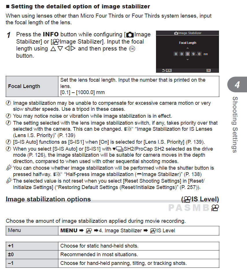

ac6000cw Posted March 18, 2025 Share Posted March 18, 2025 3 hours ago, zlfan said: After adding sharpening, the C4K 60p looks usable, C4K/UHD 60p is softer on the OM-1 than 24/25/30p - see this dpreview video stills comparison Sharpest video modes are C4K/UHD at 24/25/30p 10-bit. Re. the IBIS performance - I don't own any manual lenses, so can't test the IBIS in that situation, but I often use non-stabilized long telephoto lenses like the Oly 75-300mm and Pana 100-300mm (with lens OIS turned off) for wildlife video. With the video stabilization 'IS Level' set to +1 (the highest setting) I can get usable handheld video at 300mm provided I'm leaning against something or sitting down to provide a bit of extra stability. Is the video stabilization working OK with native MFT lenses? If not, I'd suggest doing an 'Initialize All Settings' and starting again (especially if this is a used camera). Note that some of the stabilization settings are separate for stills and video, so you might need to set the manual lens focal length separately for stills and video: Link to comment Share on other sites More sharing options...
zlfan Posted March 18, 2025 Author Share Posted March 18, 2025 6 hours ago, Snowfun said: If, for some reason, you are happy with the quality of the gopro12, why are you even thinking about other cameras? If you have found the camera which does what you need it to, isn't that sufficient? GoPro is fixed lens camera. I have a collection of mf lenses, so I need OM1 for mf lenses. Link to comment Share on other sites More sharing options...

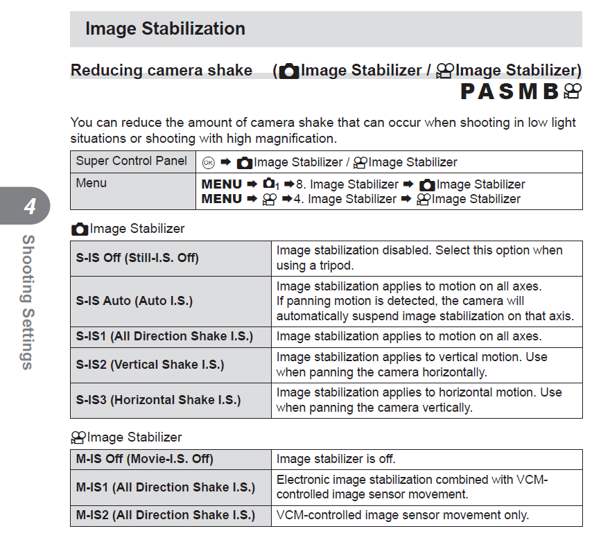

zlfan Posted March 18, 2025 Author Share Posted March 18, 2025 6 hours ago, ac6000cw said: C4K/UHD 60p is softer on the OM-1 than 24/25/30p - see this dpreview video stills comparison Sharpest video modes are C4K/UHD at 24/25/30p 10-bit. Re. the IBIS performance - I don't own any manual lenses, so can't test the IBIS in that situation, but I often use non-stabilized long telephoto lenses like the Oly 75-300mm and Pana 100-300mm (with lens OIS turned off) for wildlife video. With the video stabilization 'IS Level' set to +1 (the highest setting) I can get usable handheld video at 300mm provided I'm leaning against something or sitting down to provide a bit of extra stability. Is the video stabilization working OK with native MFT lenses? If not, I'd suggest doing an 'Initialize All Settings' and starting again (especially if this is a used camera). Note that some of the stabilization settings are separate for stills and video, so you might need to set the manual lens focal length separately for stills and video: Thank you very much for your help. For ibis in video, I use M IS 1, mechanical plus digital. Link to comment Share on other sites More sharing options...
zlfan Posted March 18, 2025 Author Share Posted March 18, 2025 6 hours ago, ac6000cw said: Note that some of the stabilization settings are separate for stills and video, so you might need to set the manual lens focal length separately for stills and video: Link to comment Share on other sites More sharing options...
zlfan Posted March 18, 2025 Author Share Posted March 18, 2025 Maybe this is the key. I remember that I set the focal length in M mode for the 120p burst mode. I will check if the video mode focal length is set up. Thanks a lot. Link to comment Share on other sites More sharing options...
