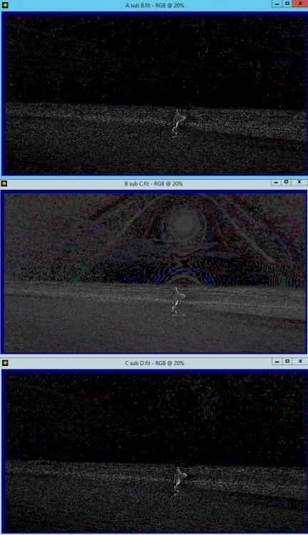

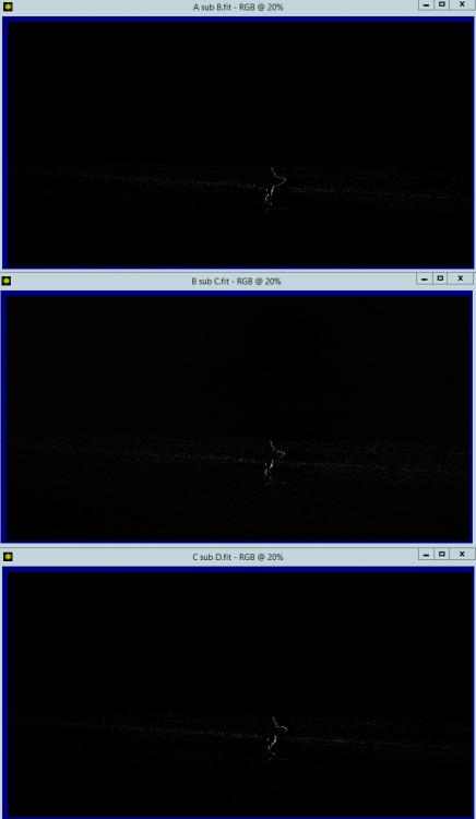

You know, I didn't even put flicker and exposure drift together -- I just thought it was a flicker and had imagined the exposure drift as being something different in my mind.  There's definitely exposure drift.
I ran some numbers on the still frames from ProRes clips exported as 16-bit TIFFs.
Two bright frames (L / R / G / B average + SD).  The total range is 0-65535
A. 48059 + 17964 / 44718+17233 / 46517+17824 / 47545+18283
B. 48059 + 17967 / 44718+17235 / 46517+17824 / 47545+18285
So it's pretty close.  Then you get to the flicker.  First, the brightness drops by 1.18%
C. 47288 + 17952 / 43497+17231 / 45746+17810 / 47031+18252  (total range is 0-65535)
Then the red frame gets messed up with the range from 257-65535 instead of 0-65535
D. 47288 + 17951 / 43974+17233 / 45746+17810 / 47031+18252
The error in the lower limit of the red channel suggests that there may be an encoding error.   I'm going to see if I can transcode directly to TIFFs instead of ProRes and will follow-up.

Well, I *was* shooting in auto mode -- so it may not be 100% a bug.  The flickering is happening faster than I would expect a traditional auto-exposure mode to deal with...
Those numbers quantify how much flickering there is. The signal only dips by 1.18%.  So even thought it LOOKS bad visually, electrically* the difference is 1.18%.
We can see those differences thanks to the precision of the HEVC encoding, and it's possible that other cameras have similar problems which we just aren't noticing.
Link to post
