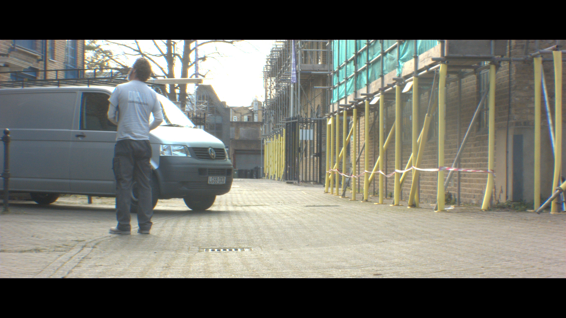

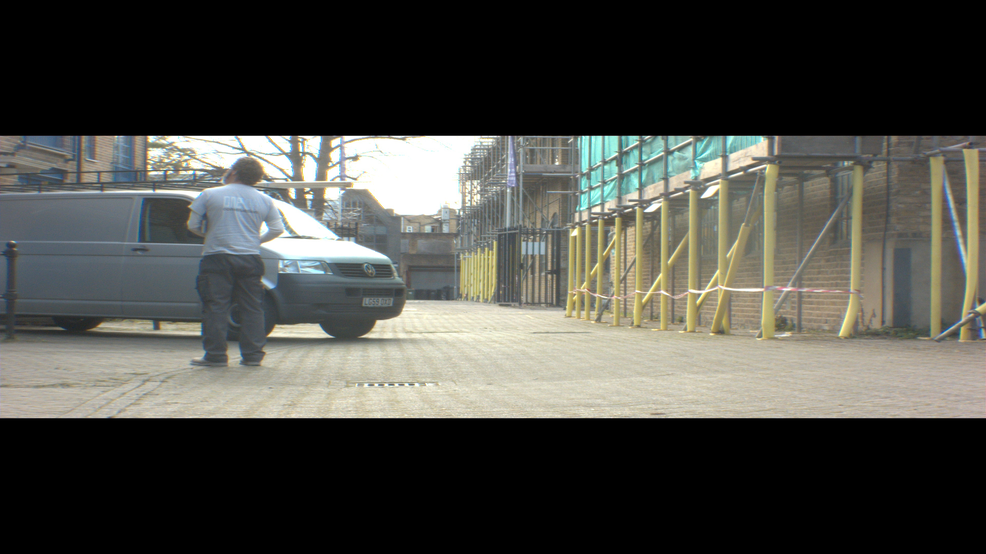

Quit Something Now 0 Posted April 3, 2015 Share Posted April 3, 2015 HiI'm a little confused by all this..I have shot 16:9 footage on my BMPCC using my x2 Kinoscope adapter.I have imported it into a standard 1920x1080 sequence..Then reduced the vertical height by 50% but it doesn't look right..I have tried 75% and it looks better.. Or maybe my eyes are going funny..What do u think? Quote Link to post Share on other sites
Russell Anway 9 Posted April 4, 2015 Share Posted April 4, 2015 I don't totally follow your workflow, but the first one looks 100% correct. Moreover, in premiere it's easy to check, there are percentages beside your pixel number, and if you are finalizing in a 1080p frame (and why would you final in anything bigger when nearly no one's monitors can display that added detail?) your aspect ratio really doesn't matter, there is no standard for web. So if the percent value of your height is half of the percent value of your width then your desqueeze is right. Pixels are sort of beside the point, since you are really after the ratio. That's it.I usually do something close as needed (a little zoom and reframe here and there is all good) and then use a cine scope overlay to cover my creative dalliances. Quote Link to post Share on other sites
