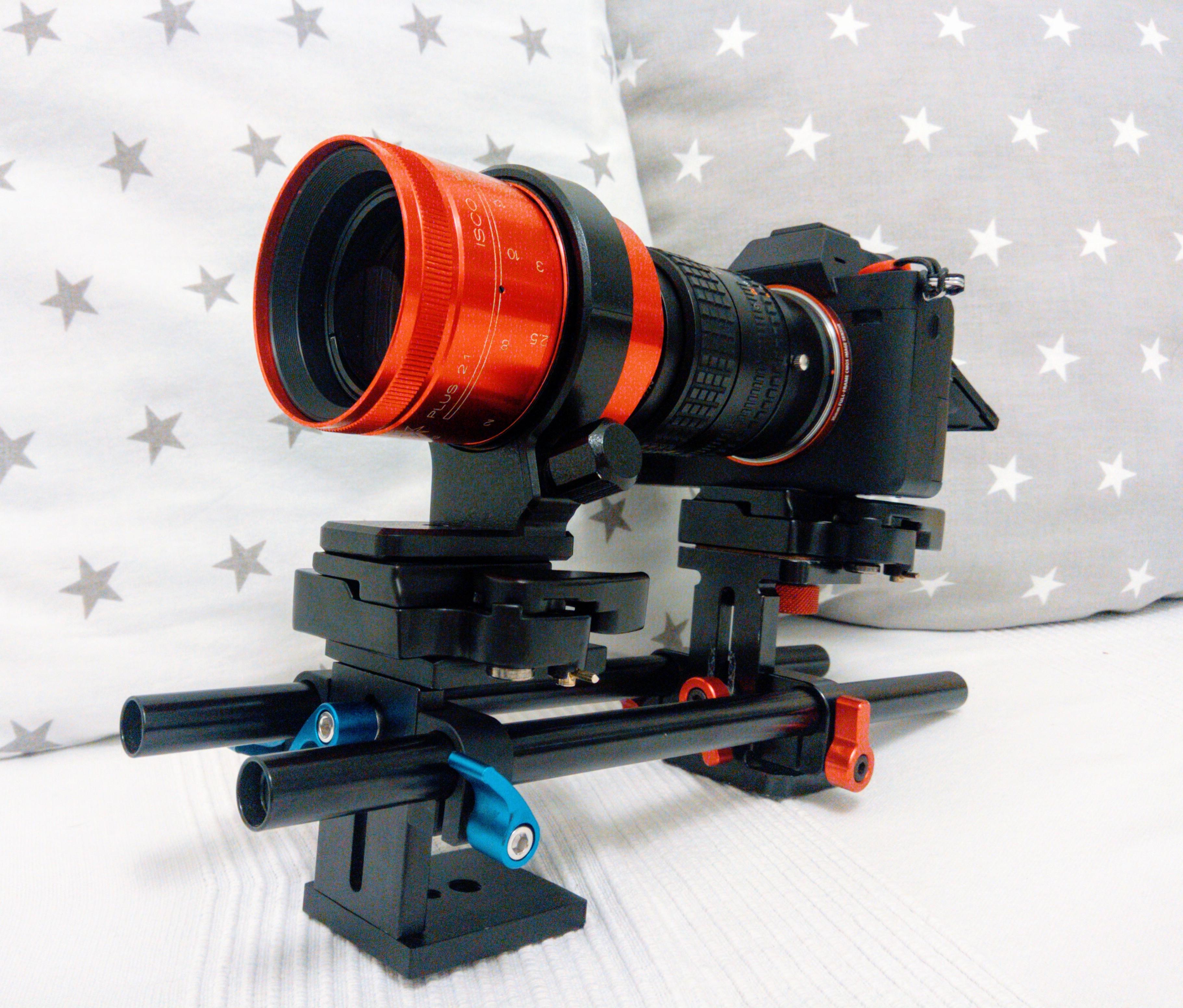

My setup looks like this:

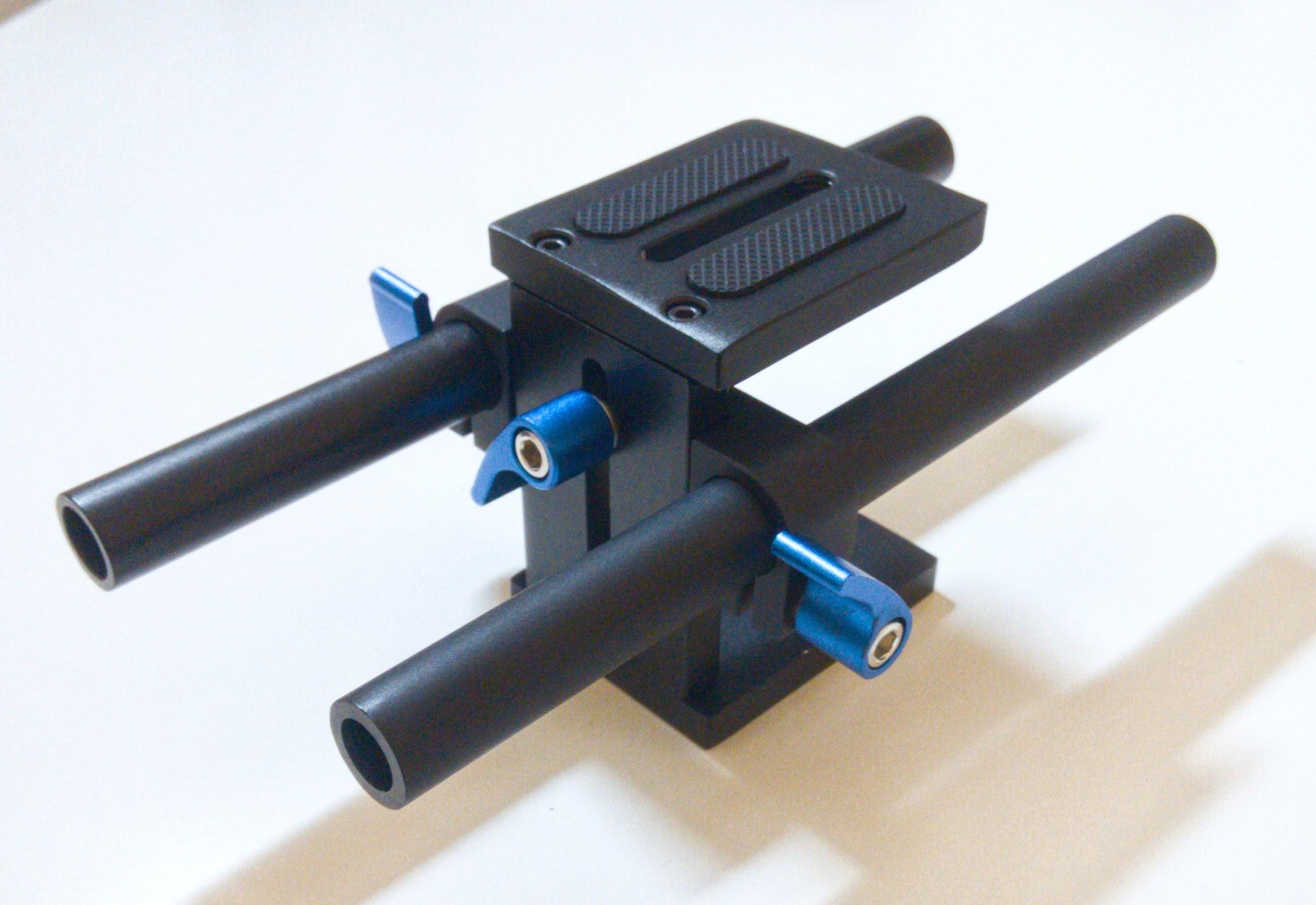

I used a lens collar to secure the ISCO in place, and then screwed it into a baseplate from aliexpress, which allows me to change the height.
Here is the link to the baseplate:
https://s.click.aliexpress.com/e/b9fcKPHR
(pictures show a version with plastic knobs, but in the end I got metal ones; quality is okay)
