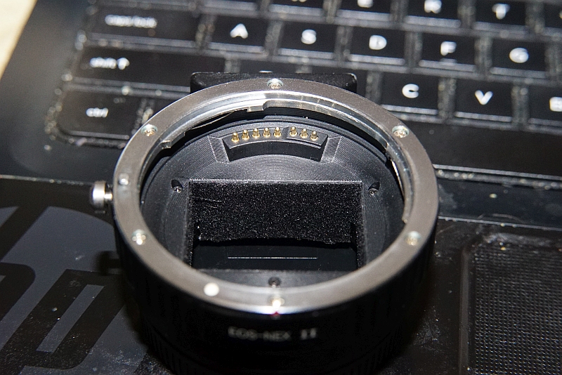

noone Posted February 26, 2017 Share Posted February 26, 2017 The Fotga and no name. Plenty of space in each for a thin filter but if you got the size right, the Fotga could have one slip right in with luck. Metabones and Commlite (I found my junk box) are fairly similar to the Metabones. The Metabones has a larger scalloped hole than the others (designed that way for use with tilt shift lenses I understand). Link to comment Share on other sites More sharing options...
noone Posted February 26, 2017 Share Posted February 26, 2017 Damn Damn Damn! My smallest filters are 43mm (for the filter drawer of my Tamron 300 2.8.) I have the original clear glass the lens came with and also a IR filter I got to experiment with. I had to file the IR filter edges down to get it to fit. IF I took the glass out of the IR filter, I think it would fit nicely in the Fotga circle. Decisions decisions, do I destroy the filter to try this or do I keep it for mucking around with IR and 300 2.8! Let me think about it. Mattias Burling 1 Link to comment Share on other sites More sharing options...

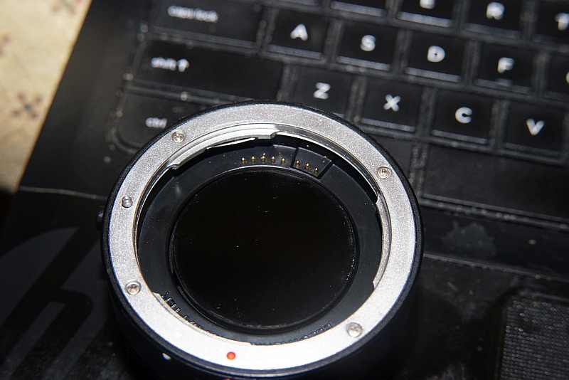

noone Posted February 26, 2017 Share Posted February 26, 2017 Well I'll be! I destroyed the filter. The edge was soft aluminium so was simple enough to file the edge off and have the glass just fine. This is going to be fun. The filter fits right in. It might be a little loose but once you put a lens on it seems ok. An EF-S lens doesn't seem to fit (probably for the same reason Canon FF cameras can not mount them). That means my 18-55 APSC kit lens is out but my EF 100 f2 is ok (for fit at least). Sticky tape would work well to hold the filter in too I think. Amazing. With my A7s and Fotga adapter I am getting auto focus indoors with a 750nm IR filter and can see easily in the EVF! OP, This will easily take two filters (one inside, one on the lens front though if it is any good or not is another story. Two snaps. The filter glass sitting loose in the adapter and one taken with the lens and filter in place auto focused. This calls for more 43mm filters for me! Thanks for the thread, this will be fun (though add to more cost I can not afford). As for the IR image, remember it is just a first snap in the excitement and is with AF at ISO 51200 and 1/15 with a 100mm lens at f2. Have to check it with my 17 TS-E too! Mattias Burling and Ben J. 2 Link to comment Share on other sites More sharing options...
noone Posted February 26, 2017 Share Posted February 26, 2017 YES! It works with my 17 f4 L TS-E. I wont post any of the rubbish samples I just took but this is going to be a lot cheaper using a 43mm piece of filter glass instead of buying a 150mm IR filter to fit in my X-Pro filter holder. Now I really have to see if anyone makes a 43mm circular apodization filter that works like an STF lens that I can use with my 100 f2. There is a company that makes them I think but I am shuddering about the price. Mattias Burling 1 Link to comment Share on other sites More sharing options...
