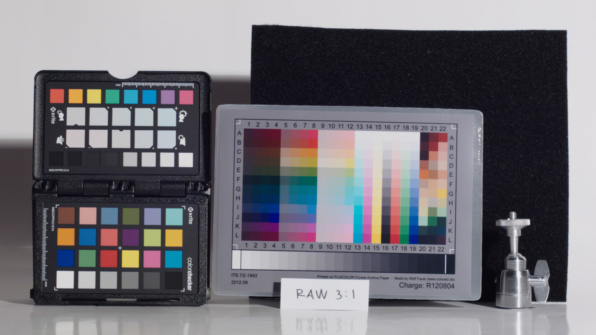

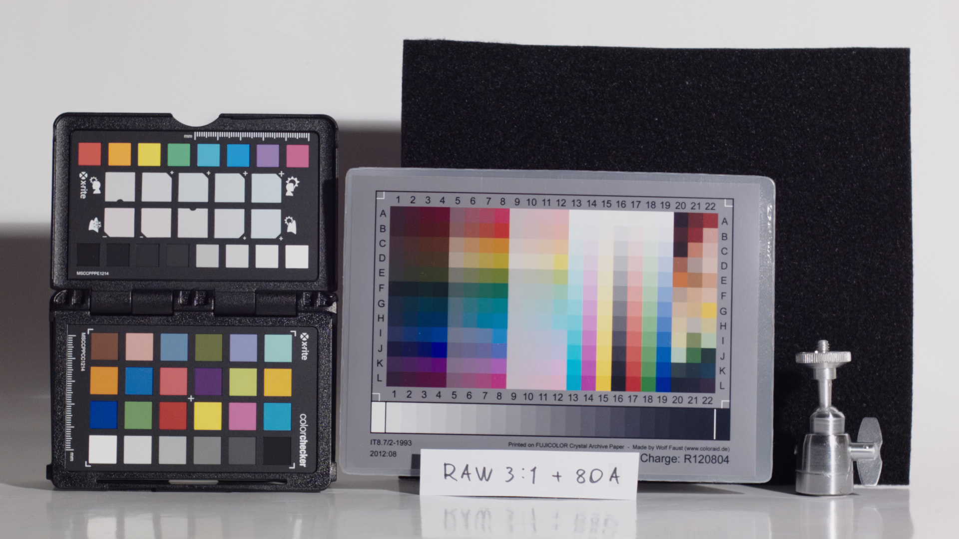

shijan Posted February 5, 2017 Share Posted February 5, 2017 if someone still interested, here are two frames from my early tests of BMMCC done with Hoya UV-IR filter+Hoya 80A and with Hoya UV-IR filter only. As light source i used 500W halogen lamp. In Resolve i adjust WB by the grey Color checker patch (third from the left). Color conversion done with custom generated LUT in LUTCalc app (output gamma Alexa-X-2, output gamut LC709). To my opinion 80A filter makes some things better but it is not too perfect. It rises color temperature but also adds cyan-green tint to the image which eats saturation in greens when you try to adjust image to netural grey balance. As opposite warm temperature light souse without filter produce very low saturated and noisier yellows for same reason. Probably all those color shifts can be corrected with more complicated color correction but this is another story... tupp and Justin Bacle 2 Link to comment Share on other sites More sharing options...
tupp Posted February 6, 2017 Share Posted February 6, 2017 10 hours ago, shijan said: if someone still interested, here are two frames from my early tests of BMMCC done with Hoya UV-IR filter+Hoya 80A and with Hoya UV-IR filter only. Thanks for doing this test! 10 hours ago, shijan said: As light source i used 500W halogen lamp. OP is shooting weddings/events, so OP might often encounter incandescent tungsten which starts at less than 3200K (with a higher percentage of IR), and which is likely further dimmed (further increasing the percentage of IR). I don't know if your 500w halogens are 3200K, but using a full CTB correction (80A) probably helps OP color-wise and IR pollution-wise. However, with a full-CTB/80A filter, brightness will suffer a 1 1/2-stop to 2-stop hit, so it might be better to use a 1/2 CTB (80C?) correction. Link to comment Share on other sites More sharing options...
tupp Posted February 6, 2017 Share Posted February 6, 2017 11 hours ago, shijan said: To my opinion 80A filter makes some things better but it is not too perfect. It rises color temperature but also adds cyan-green tint to the image which eats saturation in greens when you try to adjust image to netural grey balance. Not all 80A filters are created equal. You might try one from another manufacturer. Same with CTBs and CTOs (lighting color temp correction gels). Also, filters can fade with age. Nevertheless, your corrections on the test are well within almost anyone's tolerances. Good job matching the two images! 11 hours ago, shijan said: As opposite warm temperature light souse without filter produce very low saturated and noisier yellows for same reason. I don't see a huge problem in your test (yet I do see a slight difference), but If one finds oneself without correction filters and if one is also concerned about slightly noisy channels, one can often overexpose 1/2 stop (depending on the subject/scene). On the other hand, with well-lit sets, I have never encountered noise problems shooting raw with tungsten and only IR cut filters and ETTR. Link to comment Share on other sites More sharing options...
shijan Posted February 6, 2017 Share Posted February 6, 2017 9 hours ago, tupp said: Not all 80A filters are created equal. You might try one from another manufacturer. Same with CTBs and CTOs (lighting color temp correction gels). Also, filters can fade with age. Nevertheless, your corrections on the test are well within almost anyone's tolerances. Good job matching the two images! I don't see a huge problem in your test (yet I do see a slight difference), but If one finds oneself without correction filters and if one is also concerned about slightly noisy channels, one can often overexpose 1/2 stop (depending on the subject/scene). On the other hand, with well-lit sets, I have never encountered noise problems shooting raw with tungsten and only IR cut filters and ETTR. Yes, maybe there is a reason to experiment with less stronger filters (80B or 80C). Also maybe i do a test with warmer light source closer to 2800K to see how it works. Beside different saturation I notice only only chroma noise difference in some colors, it can be easy fixed with noise reduction or chroma blur. BTW these test images are with chroma noise reduction applied, thats why the color patches are pretty clear as you can see. Link to comment Share on other sites More sharing options...

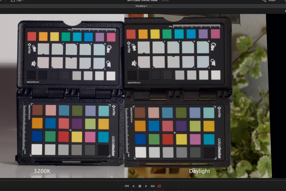

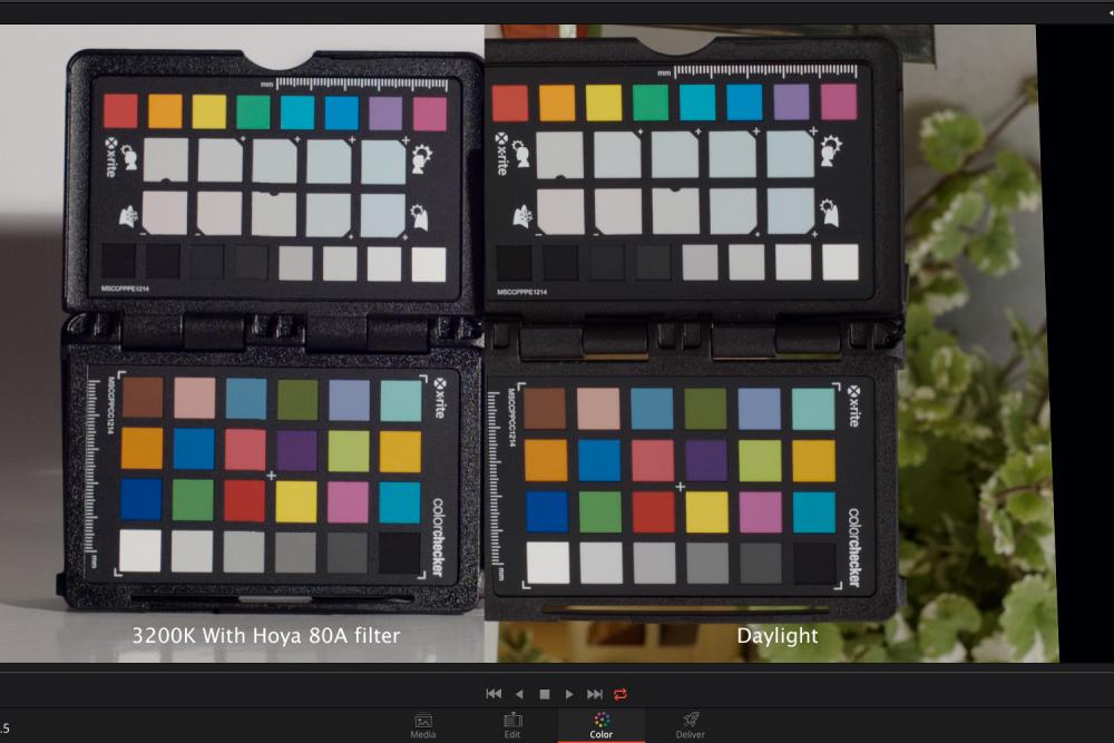

shijan Posted April 30, 2017 Share Posted April 30, 2017 Done some outdoor tests with same 50 mm Yashica lens few days ago. All shot in RAW, but processed with slightly different LUT than images earlier posts (LUT generated in LUTcalc as usual but it is more color netural than all those Amira709, Alexa-X-2 and LC709). As you can see 80A filter produce almost 100% correct colors and can be used as reference. Link to comment Share on other sites More sharing options...
