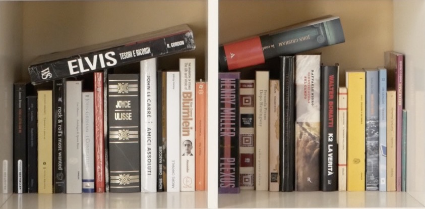

Anyway, while playin' with some ProRes for testing I noticed that FCPX is handling the resizing from 4K to 1080 in a bad way compared to the ProRes422HQ coming from MPEG Streamclip.
Please take a look at the frame grabs:
As you can see from the pictures, the ProRes version is quite a bit sharper. I put both clips straight into FCPX timeline.

To be honest, the frame grab I posted are some 400% magnification, but even looked at 100%, albeit there's a smaller difference in sharpness, the ProRes file just "pop" compared to the original.

3. Here comes the surprise: exported them and reimported and there is exactly the same difference in sharpness, hence the downscaling process also affects the export/output.
4. One clip plays smoothly, no problem whatsoever. A small project (so far I've only worked with musical videos) does not. That's why I'm looking for a more efficient way to handle the media.
Just a quick note: within Davinci Resolve there is no difference between the two clips. Same sharpness, same details.
Exported and reimported and they match.
