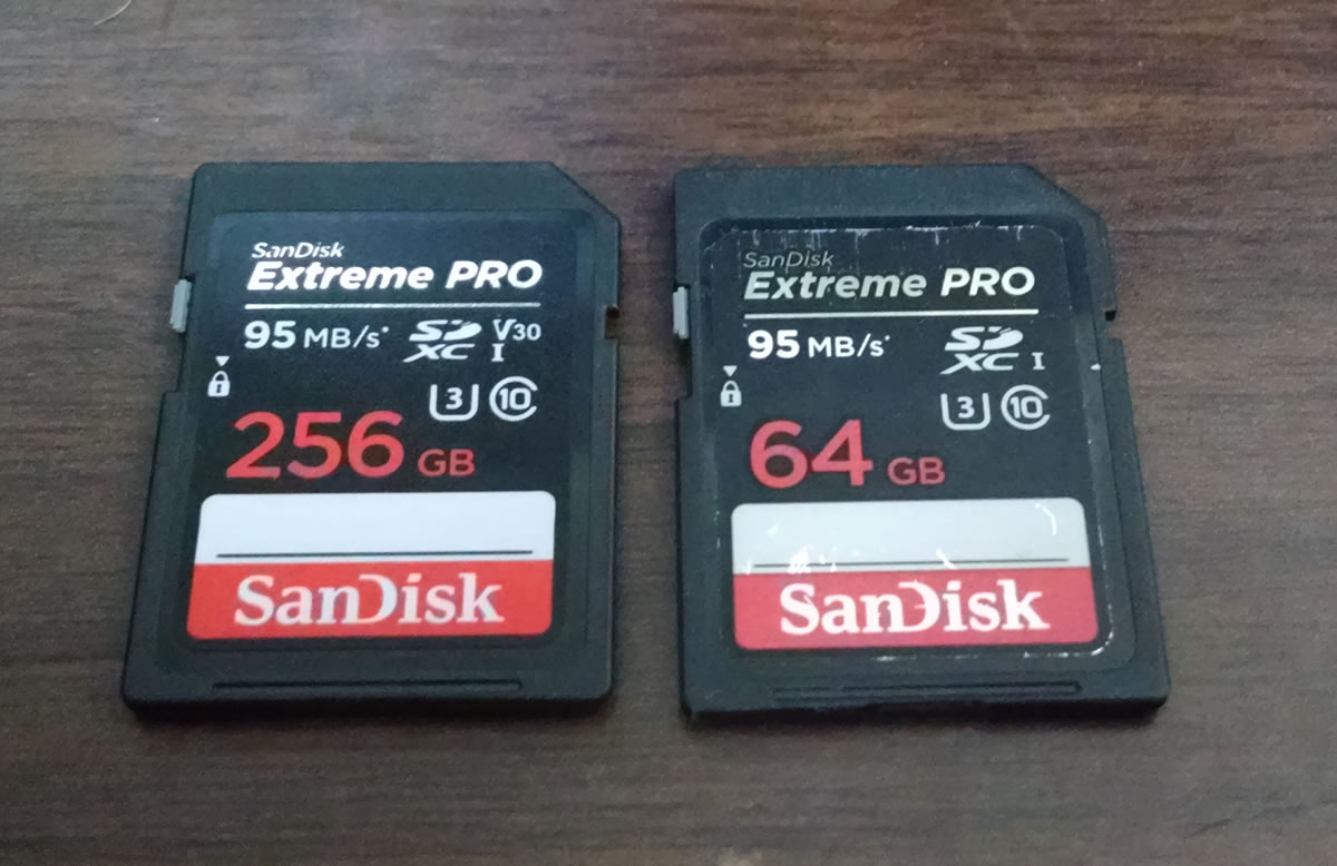

Drew Veeneman Posted December 31, 2016 Author Share Posted December 31, 2016 Interesting point about the autofocus SMGJohn. In this first shoot I has 180 on my NX1 with an old M42 lens. The NX500 was running at 160 with the Samsung 16-50mm kit lens... it was set to manual and I was tapping the screen for a focus point before recording. For SD Cards I'm running the classic Sandisk Extreme Pros like on my old GH2. (pictured below) Link to comment Share on other sites More sharing options...

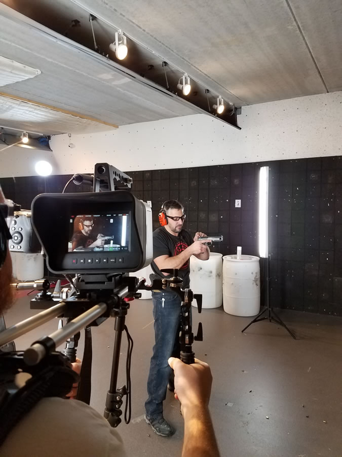

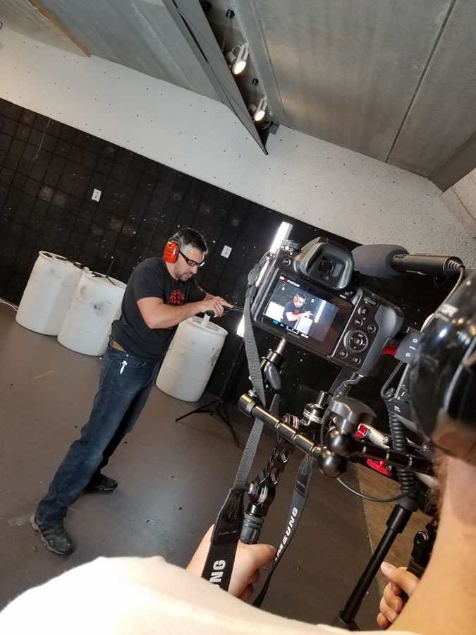

Drew Veeneman Posted December 31, 2016 Author Share Posted December 31, 2016 The first video from this shoot is now live. Check it out for a point of reference. Concealed Carry Belts: Please forgive some of the camera shake... I was testing out a dual camera rig. Although it got the job done, the rig needs improvement and... more importantly, I need more skill wielding it. Between the two cameras here I was able to cover most of my mistakes and got some interesting Dutch Angles. The NX1 was simply mounted to a magic arm off the rails. The tighter shot was the BMCC 2.5K with the 50mm F/1.4 Super Takumar and a cheap speed booster. Stopped down to about F2. With the backlighting it was flare-tastic! ... I should have put on the matte-box, but we were in a hurry. The wider shot was the NX1 with the MIR 37mm at somewhere around F4. Somehow, although Sang and Mickey where standing next to each other, I really only managed to get Sang on the left in focus. That's user error. I tried to cover the mistake up with Luma Sharpen in Resolve... good enough. --- Alright, lets try picking up where I left off. Grading... The Samsung cameras put out a solid image with plenty of detail as you would expect. I used Andrew Reid's Flat LUT on the front end in Resolve as I was setting levels. After that I dropped on Hook's Luma Sharpen... and then the Super Film Stock powergrade from Color Grading Central (oddly I don't see his Luster Grades pack for sale online anymore). I've been using that same powergrade since the beginning Carry Trainer videos. Lastly, from there I tweaked the base colors on the levels layer... nudging the reds and blues a little to my taste. Coming out of Resolve, I rendered the video in uncompressed 10-bit 4k for finishing on Sony Vegas Pro and final output to YouTube. Vegas is much nicer for audio... and it's just what I'm use to. In case your curious, the opening was done with some simple shots feed into the Prolost Handcrank plug-in in After Effects. It could just be the lenses, but I did like the image from the BMCC better even though it had less resolution 2.5k vs. 4k, but with 4:2:2 maybe that's debatable. 12-bit RAW still has it's advantages. They were both good, but the BMCC just looks richer with it's own kind of film grain. Once my NXL speed booster arrives, I'll try using the same 50mm Super Takumar 1.4 on both cameras. With the variation in sensor sizes, that should work-out perfectly and be a better grounds for comparison... As you can probably tell that's my favorite lens these days. Meanwhile, with my amateur shoulder shooting I could definitely see jello issues with both sensors. The thumbnail/cover image for the youtube video was a Macro shot with my my NX1 and the Canon FD 35-70 Macro zoom. I had the belts inside one of those light tents common for product photography. NX1user, SMGJohn and Juxx989 3 Link to comment Share on other sites More sharing options...

Drew Veeneman Posted January 4, 2017 Author Share Posted January 4, 2017 http://www.cameramemoryspeed.com/samsung-nx1/sd-card-comparison/ This is the study I looked at before ordering my monster 256 GB SanDisk Extreme Pro off Amazon. Link to comment Share on other sites More sharing options...
Marco Tecno Posted January 4, 2017 Share Posted January 4, 2017 Lexar 2000x is faster on my nx1. Link to comment Share on other sites More sharing options...
SMGJohn Posted January 5, 2017 Share Posted January 5, 2017 Seems like with autofocus on the camera uses a lot of processing power just for that alone so 140mbps is the most stable but sometimes, just sometimes on the NX500 it will tell you your card is too slow when you enable autofocus with 140mbps bitrate. With AF disabled it seems it can do 200 with Lexar's 2000x card, I only have Lexar cards to test so I would not know what the SanDisk can do. Link to comment Share on other sites More sharing options...
