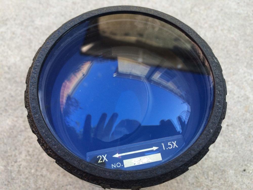

ken 109 Posted July 28, 2016 Share Posted July 28, 2016 Did any one know about it? HellVideoRazor 1 Quote Link to post Share on other sites
IshootbeforeItalk 44 Posted July 28, 2016 Share Posted July 28, 2016 Lens looks gorgious. Looks like an adjustable stretch with those markings. Quote Link to post Share on other sites
ken 109 Posted July 28, 2016 Author Share Posted July 28, 2016 4 hours ago, IshootbeforeItalk said: Lens looks gorgious. Looks like an adjustable stretch with those markings. Yes. Believe or not? Found another new world. This is the quick test video, used as 2X. Quote Link to post Share on other sites

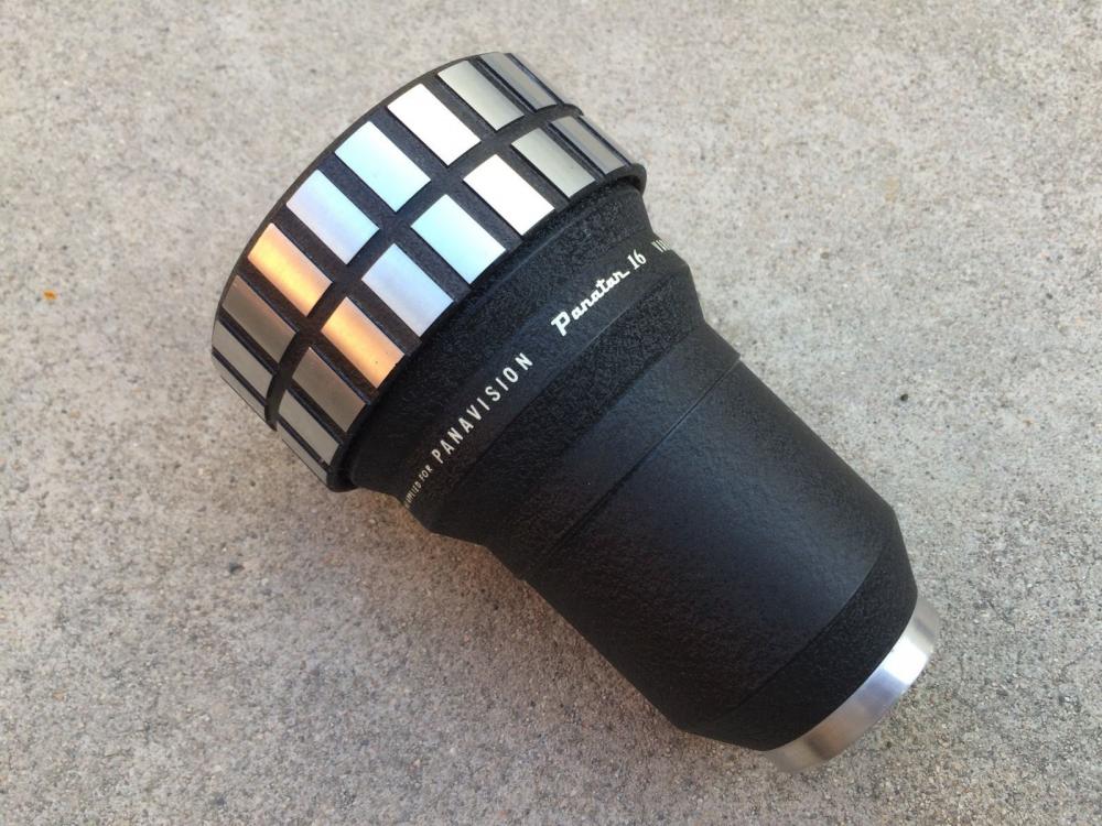

Timotheus 147 Posted July 29, 2016 Share Posted July 29, 2016 Great tinkering @HellVideoRazor. I look in amazement as it is far beyond my abilities haha...But I am a bit confused, do the Rathenower or Möller have anything to do with the Panatar from @ken's post? How is that Panatar anyway Ken? Looks like a big lens, but it's single focus you say? Can't find anything on it online, except for this old thread from here... Quote Link to post Share on other sites
HellVideoRazor 7 Posted July 29, 2016 Share Posted July 29, 2016 24 minutes ago, Timotheus said: Great tinkering @HellVideoRazor. I look in amazement as it is far beyond my abilities haha...But I am a bit confused, do the Rathenower or Möller have anything to do with the Panatar from @ken's post? Thanks. I just reused the front glass from my Panatar because they cover the 63 Möller and the 64 Rathenower for Single Focus. The prisms inside actually fit (after modification) inside normal sized Single Focus Solutions. I am about to make a house to fit them inside Rectilux 3ff-w. Quote Link to post Share on other sites

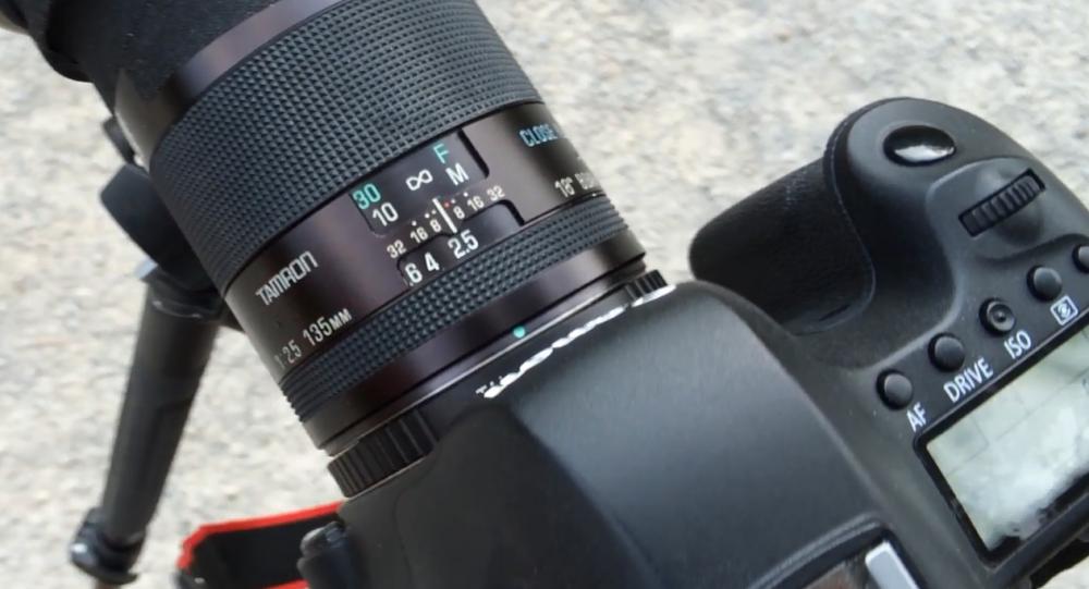

ken 109 Posted July 30, 2016 Author Share Posted July 30, 2016 I bought this lens just curious about the 1.5x~2x. But when I saw the distance scale are different from other anamorphic lens(longest is infinity). Then found it is as SLR rangefinder(shortest is infinity). So realize it contains a focus module. I tried to set prime lens in focus distance, won't get clear image. Must set to at infinity, then focusing by anamorphic lens only. The closest focus distance actually can go under 4M. Timotheus 1 Quote Link to post Share on other sites
HellVideoRazor 7 Posted July 31, 2016 Share Posted July 31, 2016 On 30.7.2016 at 4:08 AM, ken said: Do you think Möller & Rathenowerwhich which lens's flare is better? I have Möller lens only, the flare is very good IMO. The Rathenower is more blue flare. The möller has some magenta touch in the blue. On 30.7.2016 at 4:30 AM, ken said: I bought this lens just curious about the 1.5x~2x. But when I saw the distance scale are different from other anamorphic lens(longest is infinity). Then found it is as SLR rangefinder(shortest is infinity). So realize it contains a focus module. I tried to set prime lens in focus distance, won't get clear image. Must set to at infinity, then focusing by anamorphic lens only. The closest focus distance actually can go under 4M. I also found out that the 2 front glasses are single focus and of quite OK quality. If you remove the stop screws at the back, it will focus even closer. ken 1 Quote Link to post Share on other sites
