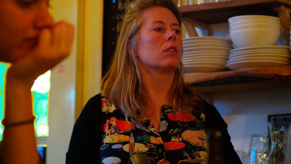

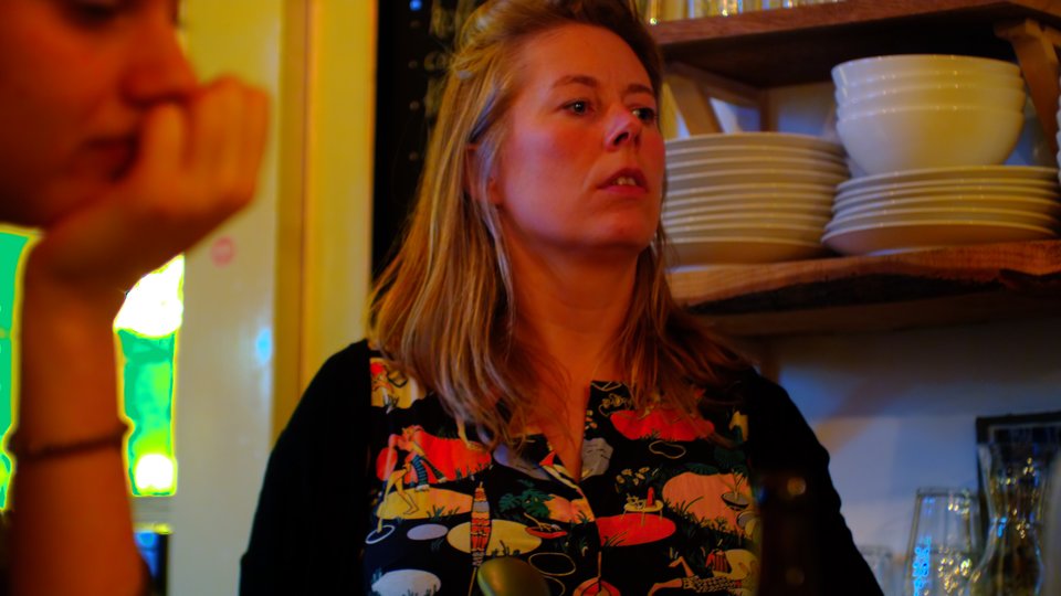

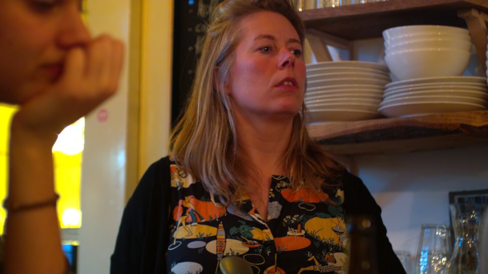

cantsin Posted March 23, 2016 Share Posted March 23, 2016 8 hours ago, Don Kotlos said: Can you send me a frame after the color matching but before the lut? Here are some frames. Admittedly, they are extreme - because they just use a primitive color-chart based color conversion to Rec709, resulting in blown-out highlights (that I could have pulled back/recovered in Resolve). Nevertheless, you see how the overexposed areas of the image create strange blue/green banding artifacts with your Fuji LUTs. I'm posting 50% scaled down jpeg screengrabs here, but could also send you 1080p 16bit TIFFs + the out-of-the camera DNG frame. - The first image is the 'pure' Rec709, the following images are the same image with your LUTs applied: Rec709 Astia Provia Classic Chrome Velvia Link to comment Share on other sites More sharing options...
Don Kotlos Posted March 24, 2016 Author Share Posted March 24, 2016 20 hours ago, cantsin said: Here are some frames. Admittedly, they are extreme - because they just use a primitive color-chart based color conversion to Rec709, resulting in blown-out highlights (that I could have pulled back/recovered in Resolve). Nevertheless, you see how the overexposed areas of the image create strange blue/green banding artifacts with your Fuji LUTs. I'm posting 50% scaled down jpeg screengrabs here, but could also send you 1080p 16bit TIFFs + the out-of-the camera DNG frame. - The first image is the 'pure' Rec709, the following images are the same image with your LUTs applied: Velvia So it took me few hours but I ve managed to fix the most of the crazy colors. One problem with these color matching techniques is that you don't sample adequately the whole space so some times interpolation can create spurious results. It is similar to the crazy coloring of the highlights in the original files that occur when Resolve tries to do a similar thing . Since there were not any colors like that in the images that I used, the points were off. I restricted the LUT to more reasonable values and here is the Velvia example of your original image: I cannot do better than this... I updated the original files so you can download them again... Link to comment Share on other sites More sharing options...
