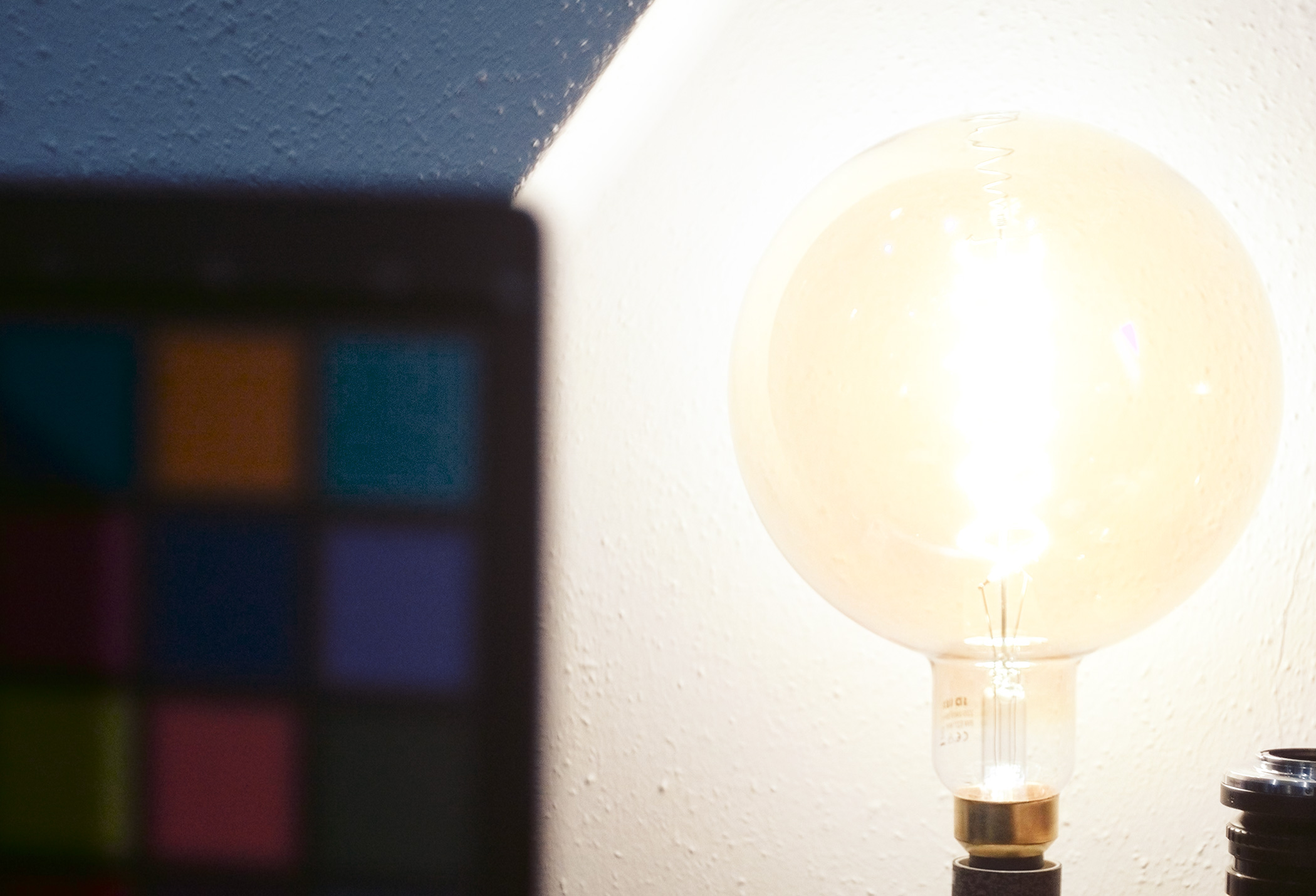

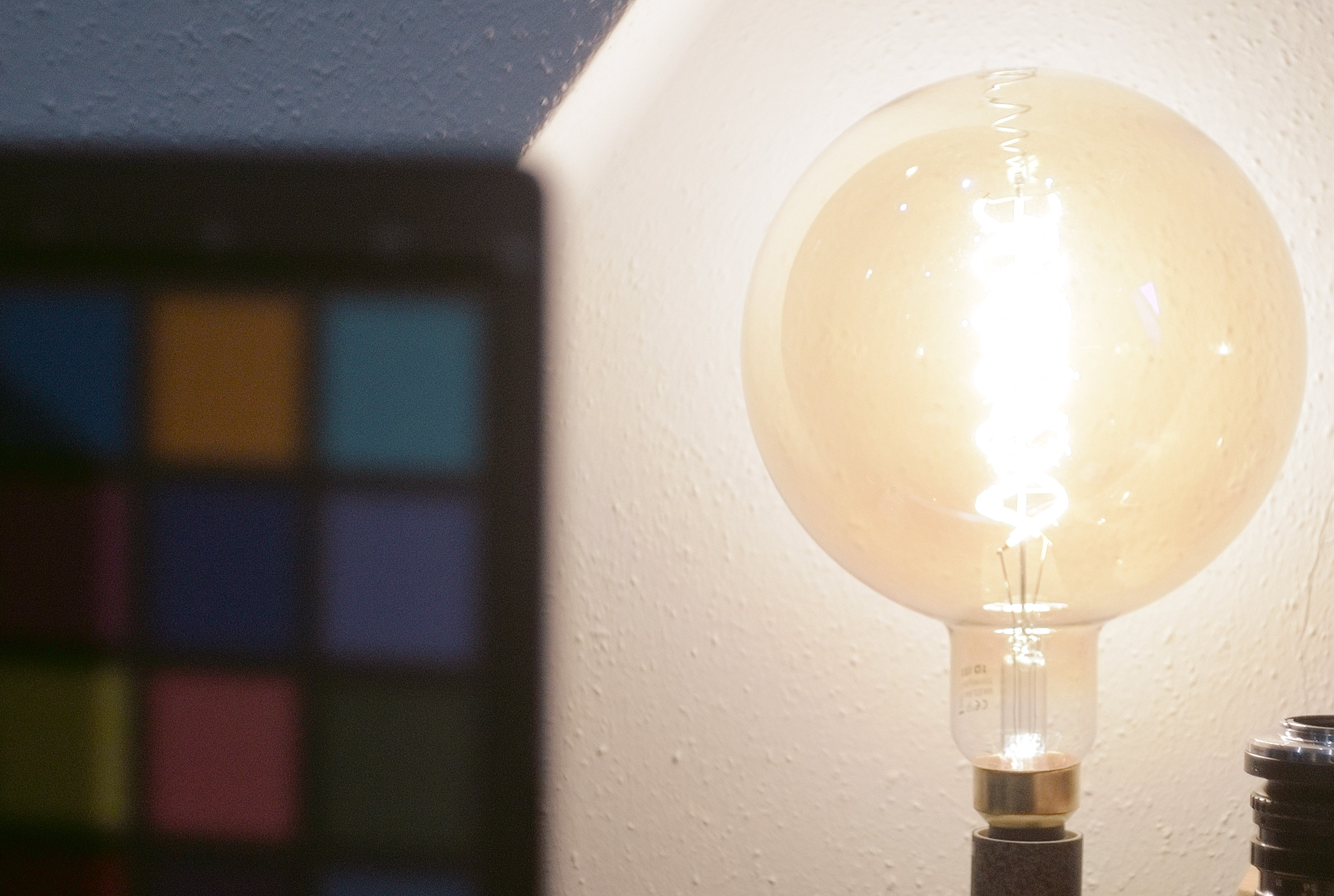

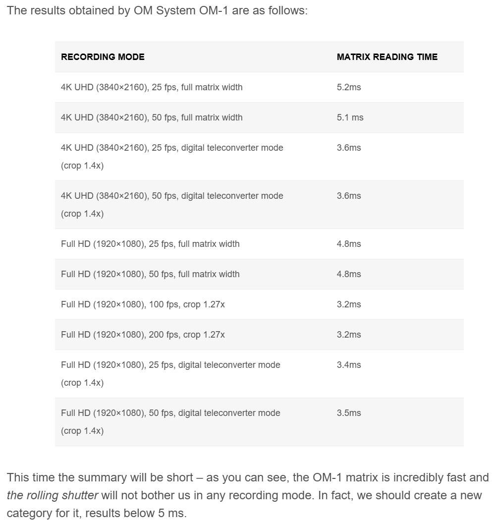

Administrators Andrew - EOSHD Posted February 6, 2025 Administrators Share Posted February 6, 2025 Since I got lucky on a mint OM-1 for 900 euros, so about 750 quid... I thought I'd see what the best modes are for video. The 4K/60p and 8bit are indeed softer, but not end of the world softer if you set IBIS to mechanical only and turn off DIS. Rolling shutter is remarkable, something like 5ms? OM-LOG is a bit funky. Too much macro blocking in the shadows (on the colour chart in the blues you can pixel peep it). Bitrate too low? Hybrid LOG Gamma mode however fairs a lot better to my eye. Higher black level like Canon LOG. Grades better. Better tonality in the highlights. HLG 10bit 100% crop (graded): OM-LOG 400 100% crop (graded): It feels like to me that OM-LOG is being clipped in the NLE. The blacks are more crushed than in Hybrid LOG Gamma. Highlights as well seem to clip really harshly. John Matthews 1 Link to comment Share on other sites More sharing options...
ac6000cw Posted February 7, 2025 Share Posted February 7, 2025 17 hours ago, Andrew Reid said: The 4K/60p and 8bit are indeed softer, but not end of the world softer if you set IBIS to mechanical only and turn off DIS. I agree (and 10-bit UHD/DCI 24/25/30p are noticeably sharper). 17 hours ago, Andrew Reid said: Rolling shutter is remarkable, something like 5ms? Yes (and for me one of its best features) - test results from this review: https://www.optyczne.pl/59.3-Inne_testy-OM_System_OM-1_-_test_trybu_filmowego_Użytkowanie.html (Google translated - Matrix = Sensor): Re. Natural versus HLG versus OMLog400 - these are contrast curves from the same review (in the 'Tonal Range' section here - https://www.optyczne.pl/59.3-Inne_testy-OM_System_OM-1_-_test_trybu_filmowego_Użytkowanie.html ). The differences are pretty obvious at the black end of the chart. Natural: HLG : OMLog400 : Andrew - EOSHD 1 Link to comment Share on other sites More sharing options...
