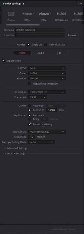

herein2020 272 Posted August 25, 2020 Share Posted August 25, 2020 Render settings do not add a delay to the footage, they just determine the quality. You did not mention what resolution (4K or 1080P), or what destination platform (YouTube, Vimeo, DVD, etc), or frame rate. But anyway, below is what I use for 1080P with a YouTube or Vimeo Destination. For your project since there is not much fast moving action, you can probably get away with a lower bitrate like 8Mb/s or maybe even 4Mb/s. The bitrate is the main thing that affects file size and quality. In the Davinci Resolve screenshot the bitrate is the 16000 Kb/s value. Not sure what NLE you are using but they all have bitrate options for rendering. I'm no expert on the whole keyframes, CBR/VBR, etc. I just experimented and watched rendering video tutorials until I got the settings that work for me. These days the only thing I change is the bitrate based on the project contents. As a reference point, DVDs have a video bitrate of only 9.8MB/s. If I really need to conserve space for example a really big project, then I would render a small part of it, the part with the most movement, and keep lowering the bitrate with each test render until you start seeing a noticeable quality difference and macro blocking, then crank it back up a bit and you now have your lowest bitrate that will not affect the visible quality. That will get you the best file size without quality compromise. Quote Link to post Share on other sites
Yannick Willox 41 Posted August 25, 2020 Author Share Posted August 25, 2020 Thanks, I need to experiment more I guess. I am starting to think the amount of keyframes are the determining factor. you say there is not a lot of movement, but 40 string players bowing happily is a lot of detailed movement. It is exactly there where things happen, and the conducter is unhappy, because where does Resolve decide to put keyframes ? The timing is very crucial here. uploading in full hd to Youtube. What happens with keyframes there ? Anyway, youtube does not keep a tight sync between image and sound anyway, so all of this is a bit theoretical. I just need a good starting point. Quote Link to post Share on other sites
herein2020 272 Posted August 25, 2020 Share Posted August 25, 2020 1 hour ago, Yannick Willox said: Thanks, I need to experiment more I guess. I am starting to think the amount of keyframes are the determining factor. you say there is not a lot of movement, but 40 string players bowing happily is a lot of detailed movement. It is exactly there where things happen, and the conducter is unhappy, because where does Resolve decide to put keyframes ? The timing is very crucial here. uploading in full hd to Youtube. What happens with keyframes there ? Anyway, youtube does not keep a tight sync between image and sound anyway, so all of this is a bit theoretical. I just need a good starting point. You actually want less keyframes not more, keyframes are mainly used for editing and help the video editing software do less work, that's why ALL-I compression is easier than LongGOP to edit even though ALL-I is typically 4x larger files. But you would never render a final project in ALL-I. When you say "it is exactly there where things happen" what things are you referring to? If you post a screenshot of what is going wrong myself and others may be able to help you better. Maybe it is something else that needs to be fixed somewhere else in the process. Your example of 40 players bowing is still nothing LongGOP and a lower bitrate can't handle. Where you will start seeing artifacts or macro blocking with lower bitrates are scenes where nearly every single pixel changes in every frame like when a drone is flying at high speed over the ocean, a timelapse that was shot with large intervals between images combined with a field of flowers blowing in the wind, etc. If the final destination for the video is YouTube then I would recommend you simply look up the latest YouTube video formatting recommendations. It sounds to me like you are overthinking it...simply follow Google's YouTube chart (they do run YouTube after all) and leave it at that. Another option is to post it to Vimeo instead, maybe have the version that you want on the client's website hosted on Vimeo then the one for everyone else posted on YouTube, also does the source video look fine before you upload it to YouTube? https://support.google.com/youtube/answer/1722171?hl=en Quote Link to post Share on other sites
