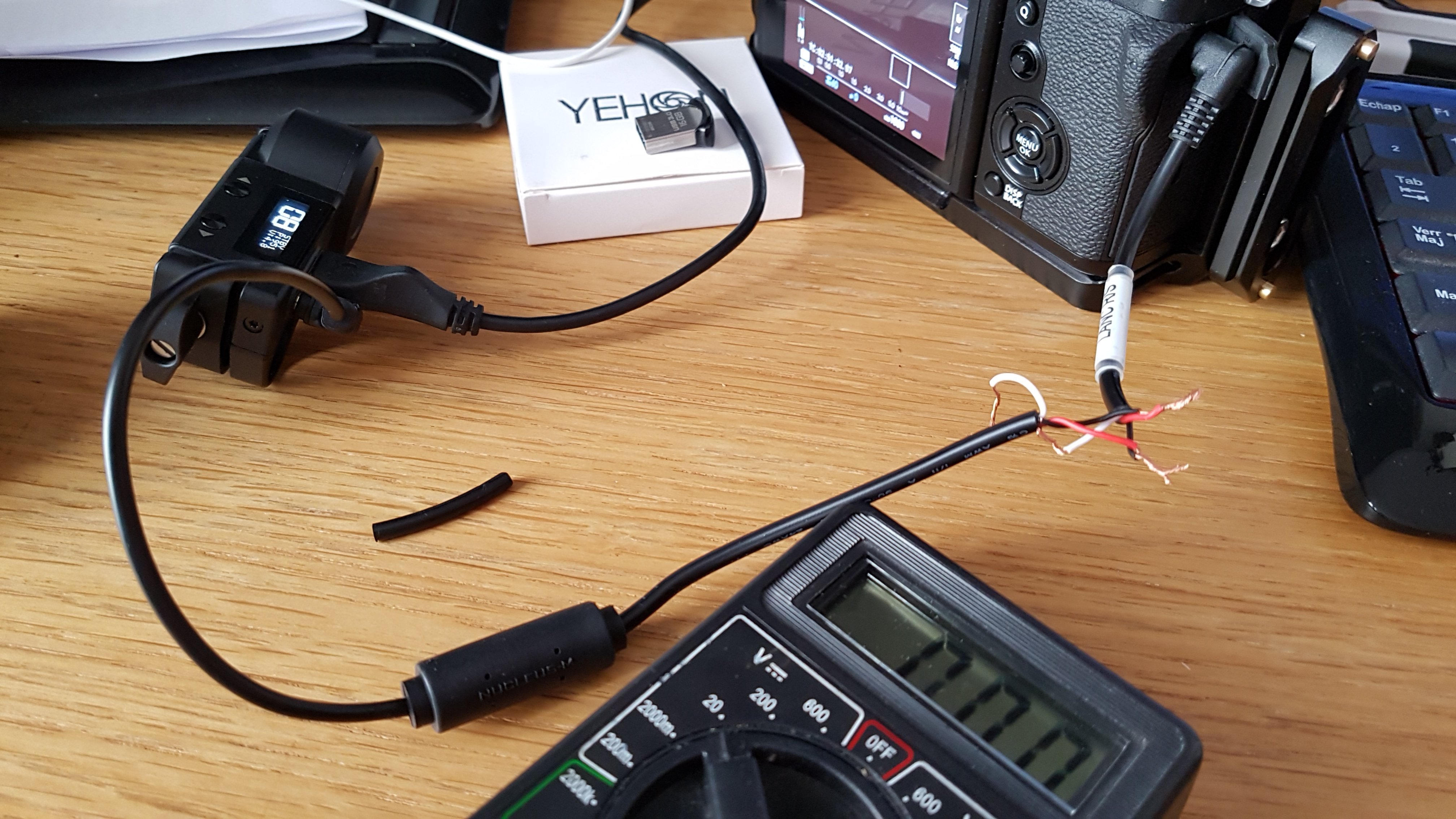

thephoenix Posted August 31, 2019 Share Posted August 31, 2019 guys i need your help. i don't get it. so as the cable i had with the nucleus nano didn't work i went for a cut to try to find what is the right wiring. when i have the red and black inverted it works, i mean it triggers the cam, but only when i touch the cables. when the cables are tied and i push the rec button on the nucleus wheel nothing happens ? don't get it. any ideas ? guess it has something to do with the power maybe. i even wonder if it is not malfunctionning because when i test it with the voltmeter there is no voltage difference when i push the rec button and i guess something should happen or it should be at 0 when not recording 20190831_113532.mp4 Link to comment Share on other sites More sharing options...

thephoenix Posted September 1, 2019 Author Share Posted September 1, 2019 8 hours ago, Andrew Reid said: Is it officially listed as compatible with the Fuji you have it plugged into? If so, buy the cable that works? come on, if it was compatible i would just have bought the cable. the cable is from titlta, the only that could have worked according to a tilta representative. well, it didn't. so i just have to figure out how to connect the wires to have it work but i might have a malfunction that is why i did this post Link to comment Share on other sites More sharing options...

thephoenix Posted September 1, 2019 Author Share Posted September 1, 2019 well, i also have a cable that works. that's not the issue. the problem is with the nucleus nano. so is the nano malfunctionning or is it something else ? Link to comment Share on other sites More sharing options...
