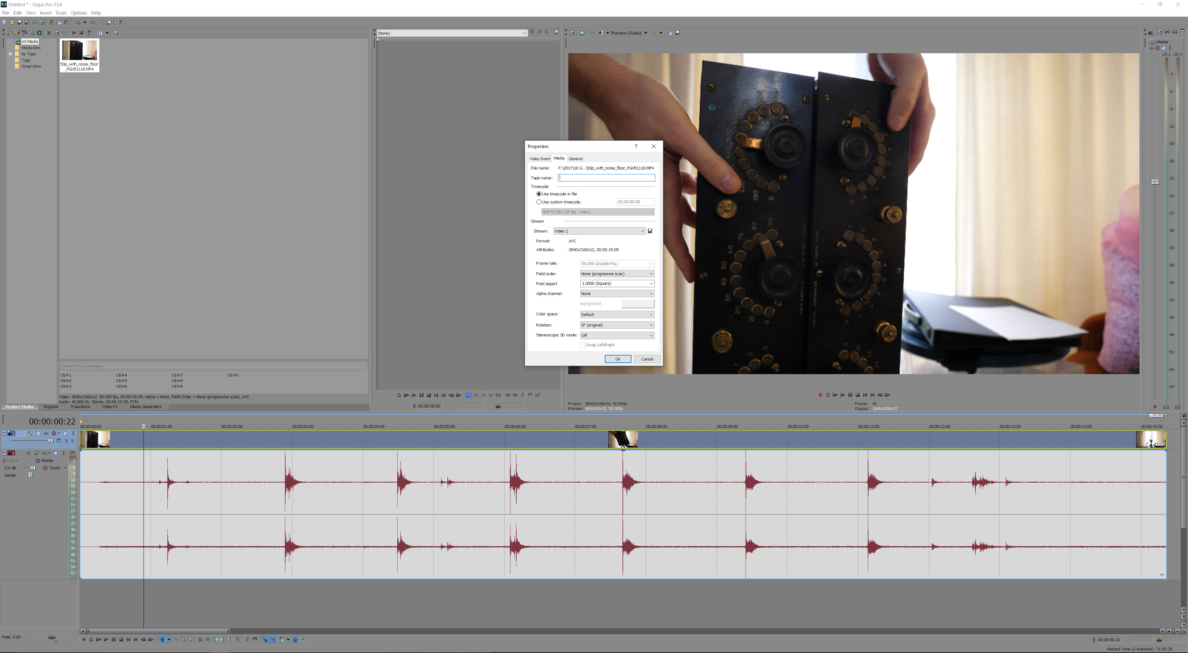

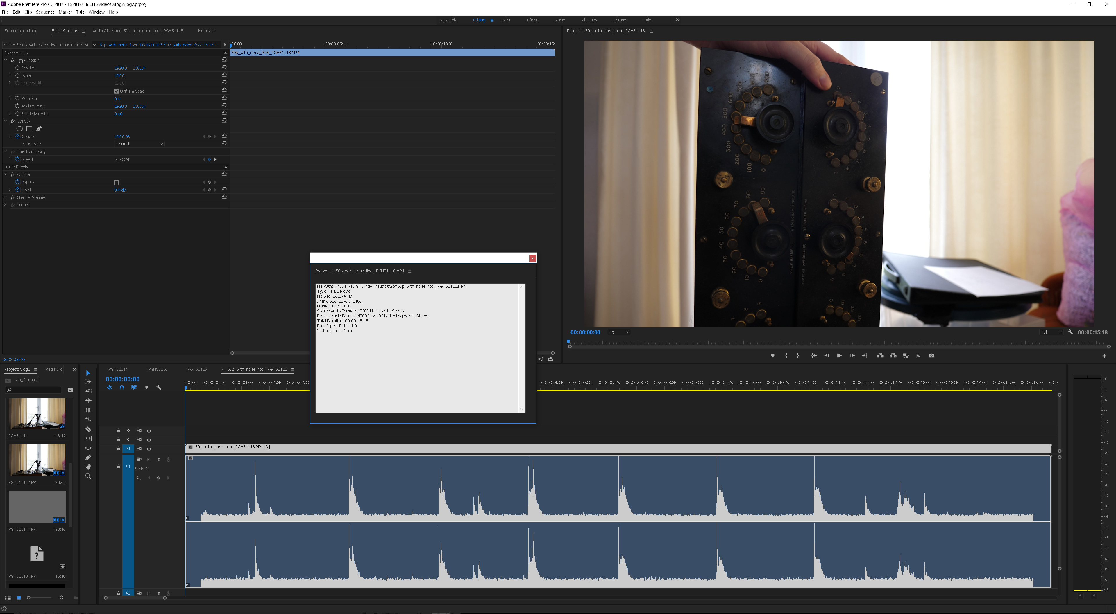

On some systems running the latest 2017 Premiere some people have a problem with the audio disappearing for the last second of each clip. https://forums.adobe.com/message/9328219#9328219 This seems to be "fixed" by renaming your .MP4 files as .MPEG files before importing. The stated duration in the properties remains the same. I still have a question about what will happen over spanned clips so we will see. Vegas Pro does not have the audio drop at the end of clips and also states a shorter clip duration.
