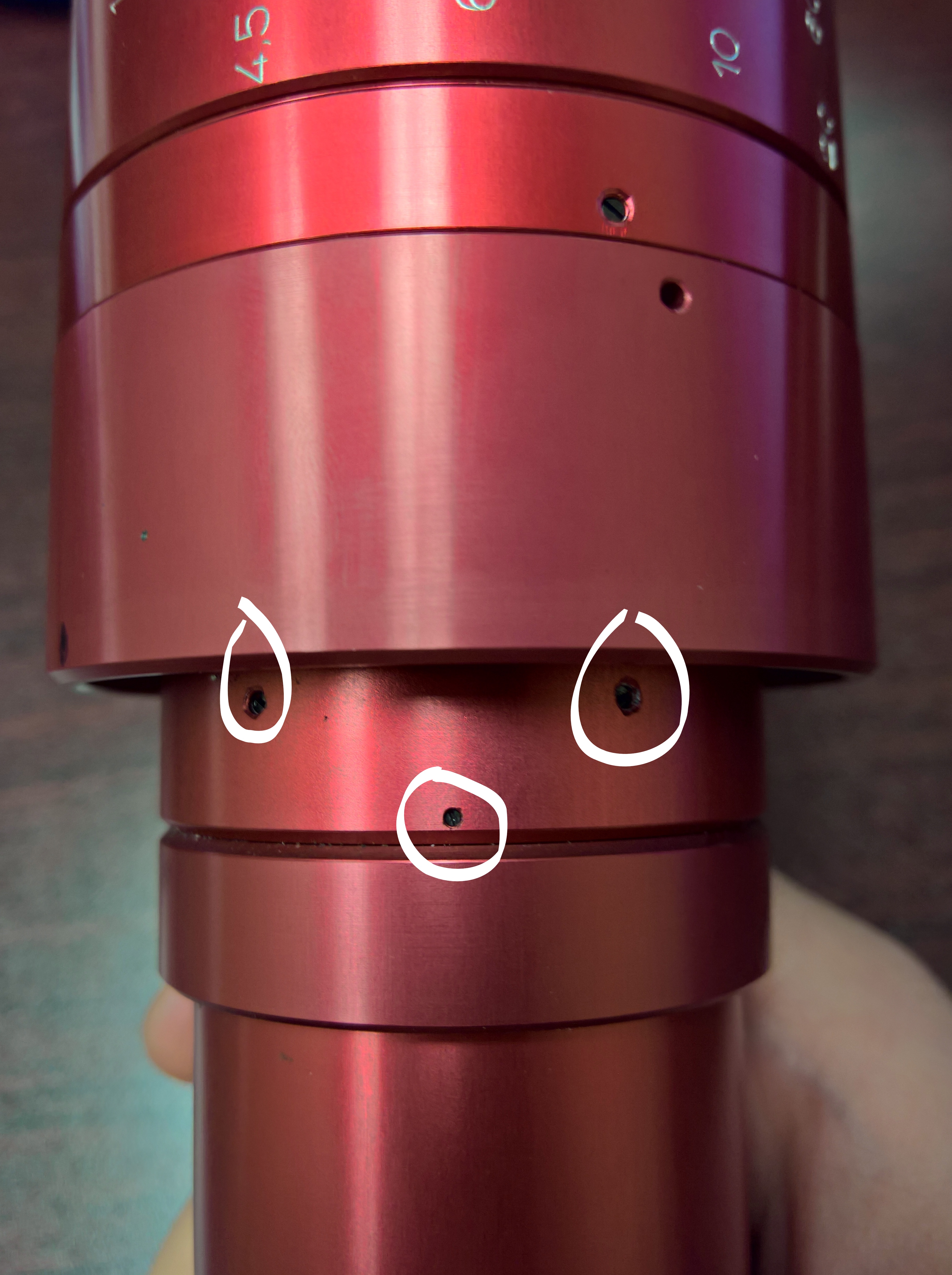

dontthroworanges Posted June 12, 2017 Author Share Posted June 12, 2017 Finally circling back to this old thread. I finally got an ISCO Ultra Star Plus as per the original post. Question though, which set screw (s) do I need to remove to unscrew the taking lens? See attached picture. Or is it none of these and it just requires a ton of torq? Let me know! Thanks. Link to comment Share on other sites More sharing options...
dontthroworanges Posted June 12, 2017 Author Share Posted June 12, 2017 11 minutes ago, whoisjsd said: The little screw is all you need to remove. Don't remove the others unless you want to re-align the back anamorphic glass again. Then, you need some rubber pipe wenches because the threads are locked. You can also try wrapping the two lenses in some thick rubber bands and using big pliers (I did this on my first one). It takes a bit of force, but it's not impossible. Good luck! Exactly what I needed to know! The rubber strap wrenches are on their way. Thanks! Justin Bacle 1 Link to comment Share on other sites More sharing options...
dontthroworanges Posted June 15, 2017 Author Share Posted June 15, 2017 Got the taking lens off. Wasn't too hard and I got lucky in that I could find a screwdriver small enough for that screw. Link to comment Share on other sites More sharing options...

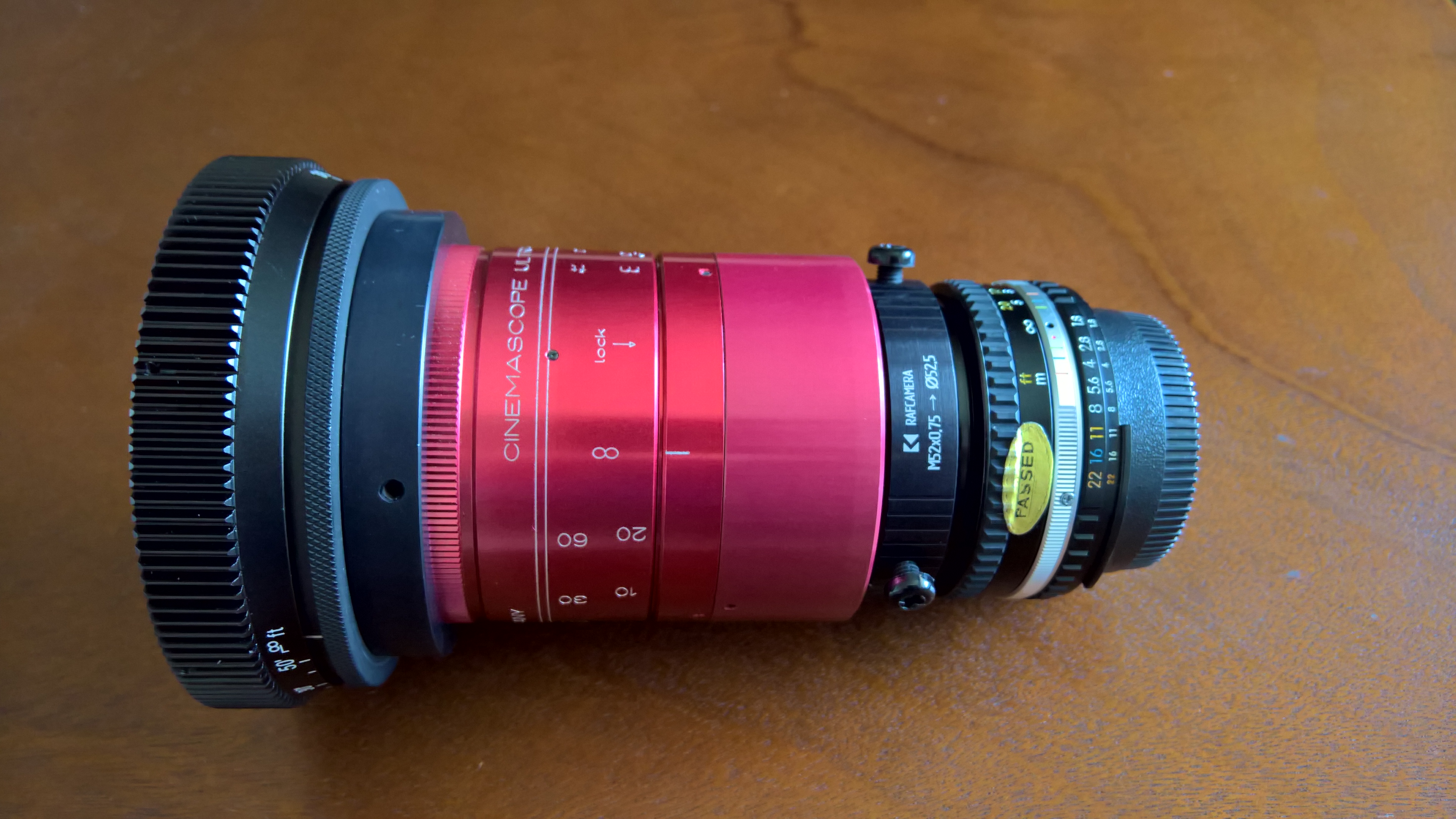

dontthroworanges Posted July 6, 2017 Author Share Posted July 6, 2017 It's done! Really happy with it especially when compared to the Sankor 16-S I had a couple years ago. It's pretty heavy but not too bad. The RAFCamera clamps are absolutely perfect and excellent quality. The posted shot was literally me running out into the alley and snapping a shot on auto. Thanks for everyone's help on this! leslie, Justin Bacle, Juank and 1 other 3 1 Link to comment Share on other sites More sharing options...
