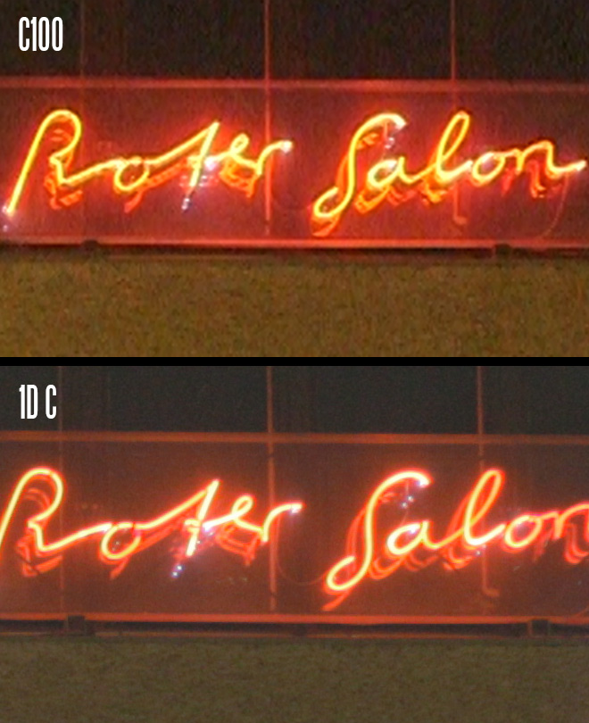

Administrators Andrew - EOSHD Posted August 23, 2016 Administrators Share Posted August 23, 2016 17 hours ago, Luke Mason said: 1DC S35 mode uses a cropped area of 3216 x 1809 photosites on the sensor. It does a 2 x 2 binning to get a 1608 x 904 RAW bayer and upscales to 1080p. Since the sensor OLPF was not optmised for this binning mode, you get slightly more aliasing shooting S35, which also makes it perceptually sharper. Oh man, would I like that 1608 x 904 RAW bayer on my CF card I didn't shoot much 1080p on the 1D C, but I did compare the 4K to the C100's 1080p and obviously the 1D C is the superior image, with much less aliasing. This was shot at ISO 12,800 - you also get a finer noise grain in 4K which is more film like and translates to less noise overall when downscaled to 1080p in post. tokhee and Dane 2 Link to comment Share on other sites More sharing options...
