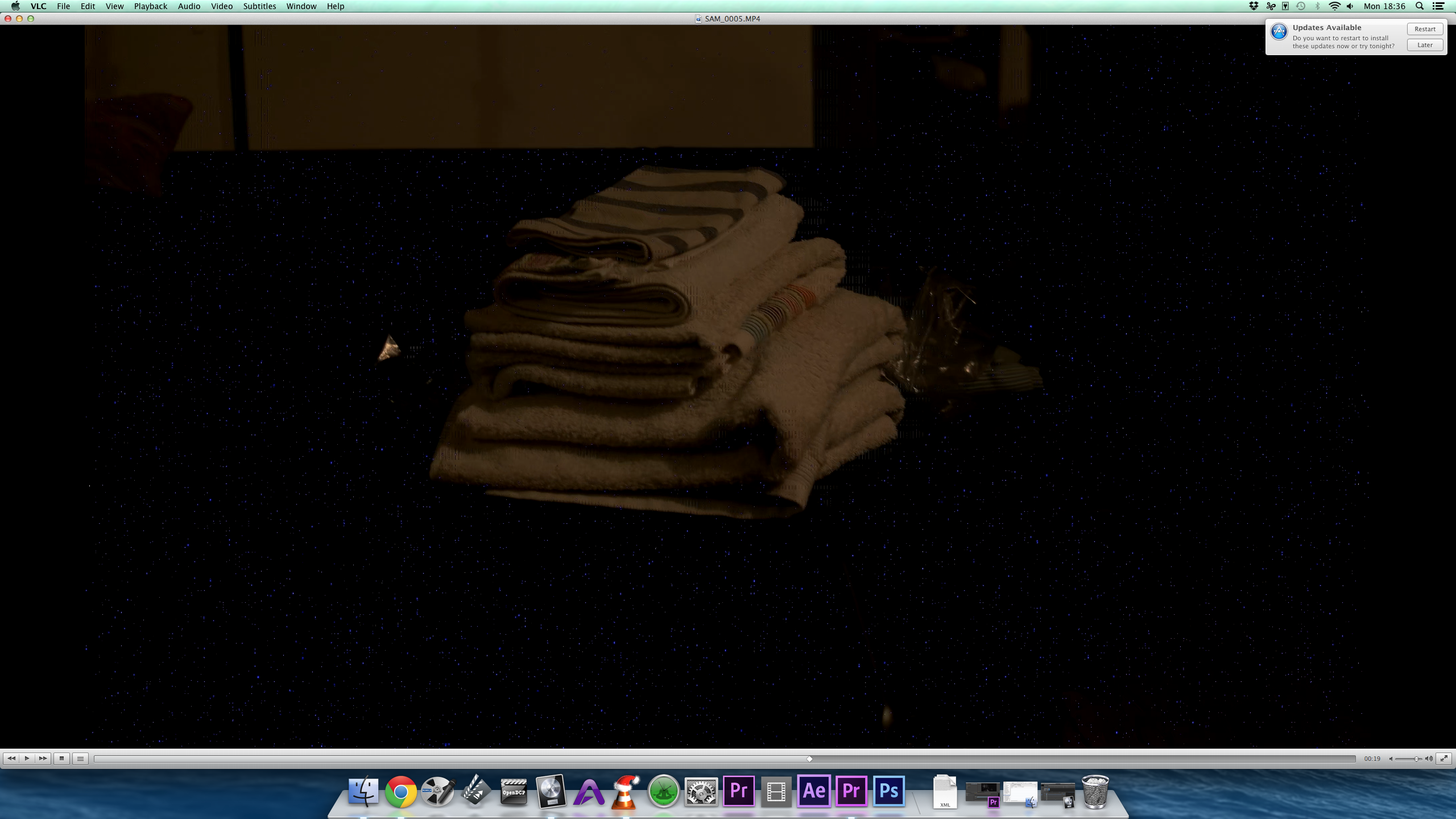

Tiago Rosa-Rosso Posted December 28, 2015 Share Posted December 28, 2015 I'm having sensor problems with my samsung NX1. There are some vertical blue scratches that appear on the side of oled screen and some blue noise. This noise is recorded into the video clips. It seems the problem occurs when the camera is recording under low light or black surfaces. Anyone experienced this kind of problem? Any tips? Link to comment Share on other sites More sharing options...

Tiago Rosa-Rosso Posted December 28, 2015 Author Share Posted December 28, 2015 Thanks for the tips. I went trough those settings and I tried MplayerX also, the problem remains. The oled viewfinder when i'm recording is presenting the same problem. Check this video. Link to comment Share on other sites More sharing options...

Tiago Rosa-Rosso Posted December 29, 2015 Author Share Posted December 29, 2015 That is normal if you are using framing mode and viewing extremely low light scenes with the aperture preview button pressed. Dark elements will contain a lot of blue noise.It shouldn't be happening otherwise.Are you using a manual lens with the aperture closed all the way down?Check this video please. Here i was using the 30mm pancake from samsung at 2.0 i believe. But the scratches on the side can't be normal. Then i hit record and the scratches aren't visible on the video but they are there is just that when I hit records the sensor crops a bit the image, also lots of blue noise appearhttps://www.youtube.com/watch?v=hWgo_psSfD0 Link to comment Share on other sites More sharing options...
