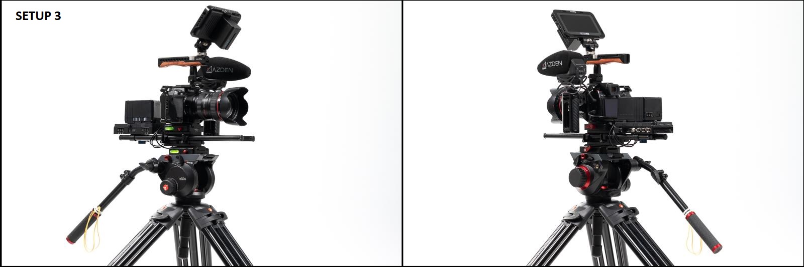

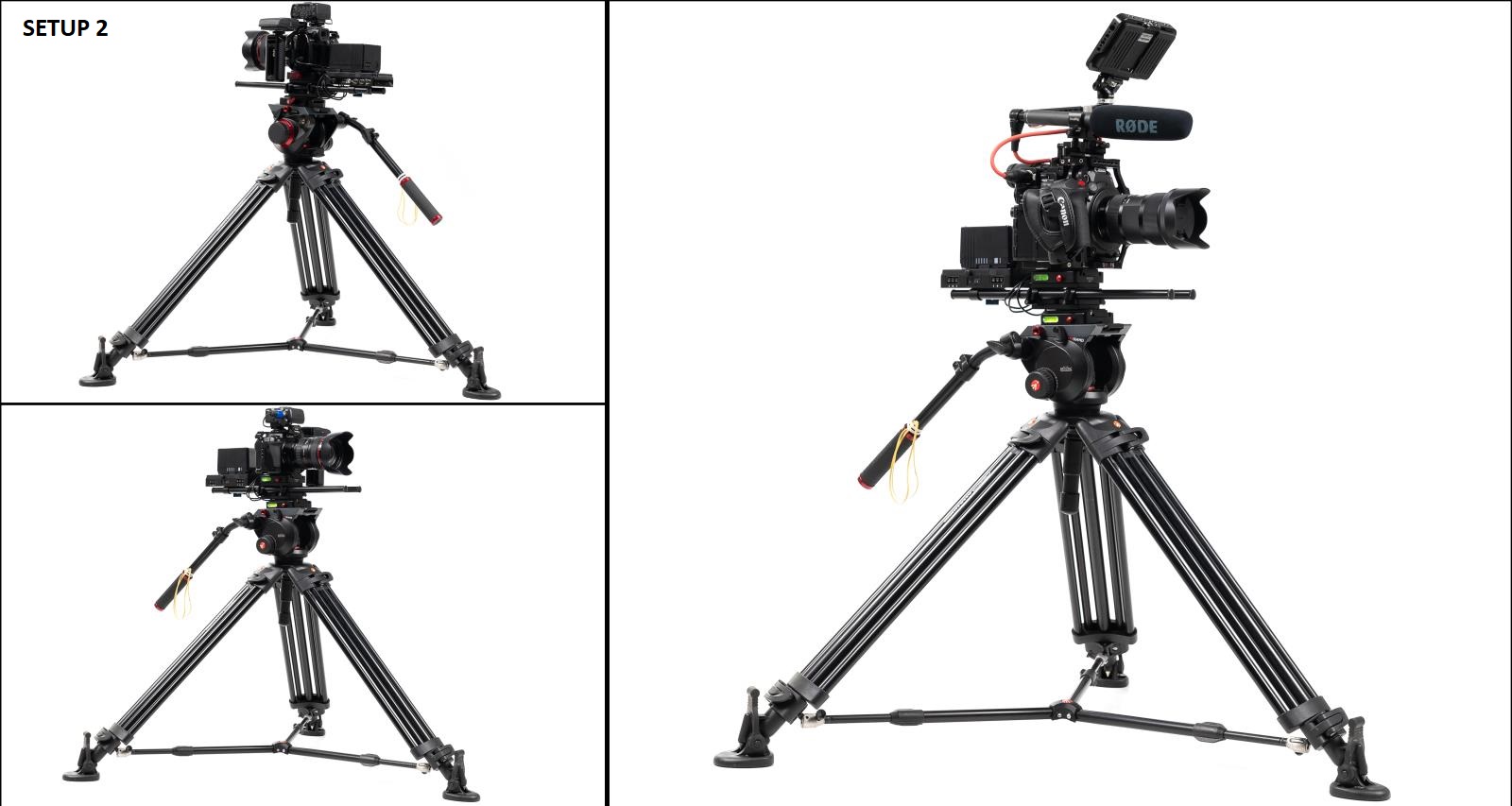

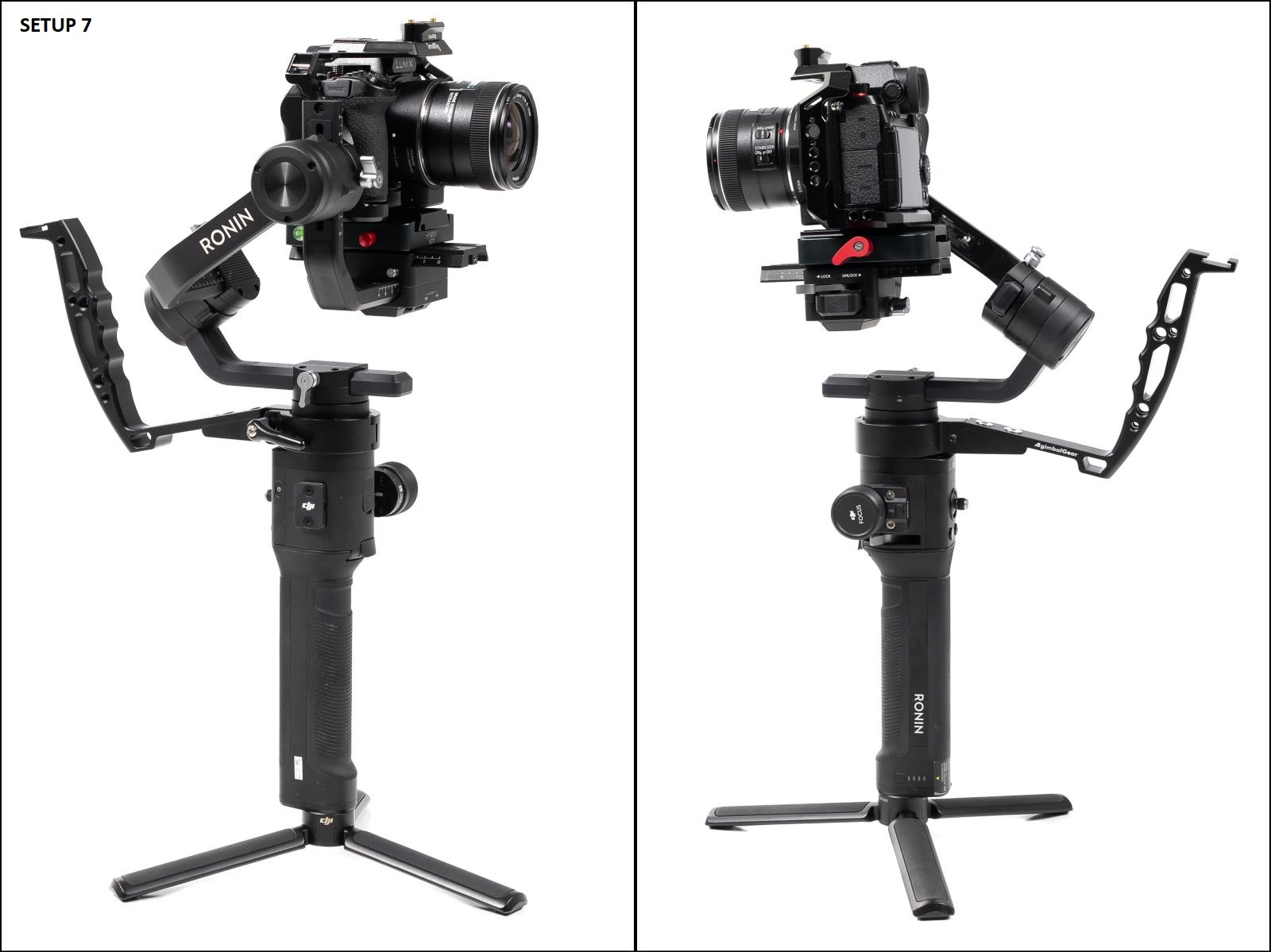

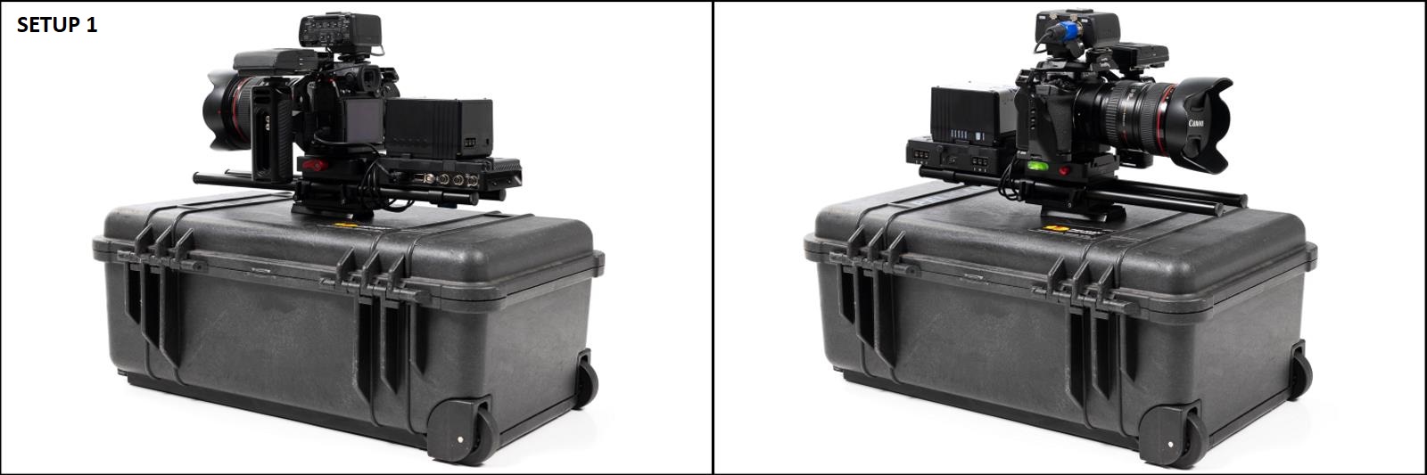

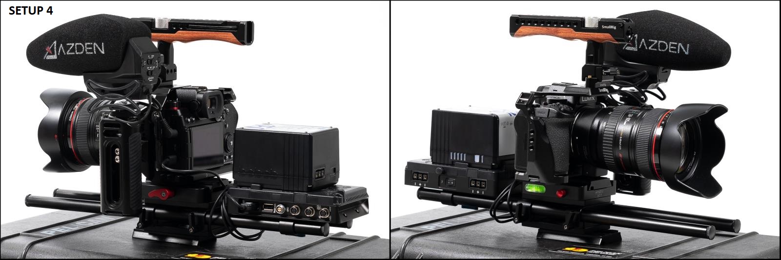

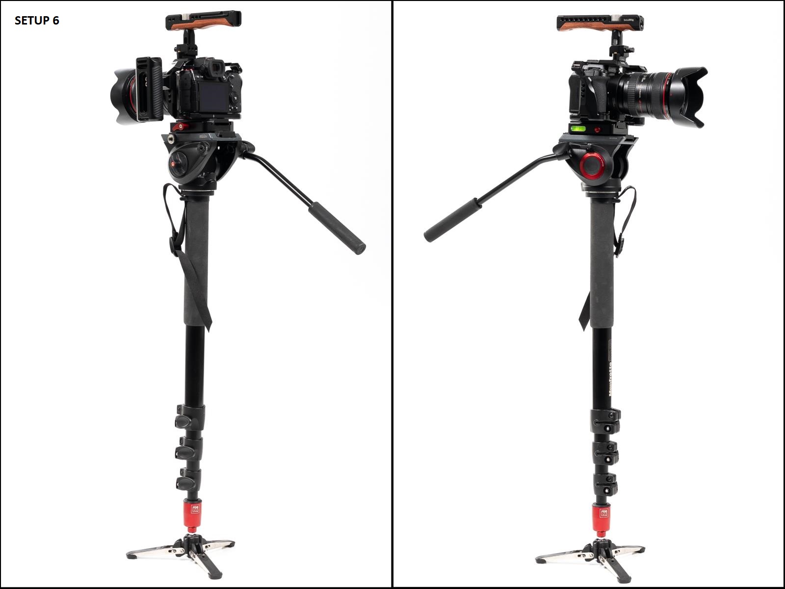

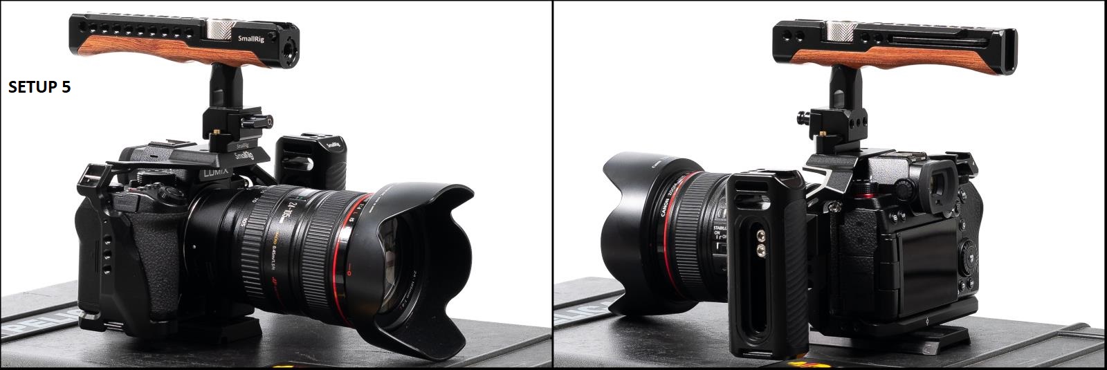

herein2020 Posted November 21, 2020 Share Posted November 21, 2020 I now have my Panasonic S5 rigged to meet every type of project that I shoot and I know how much time it can take to get your gear rigged up in a way that works for you so I figured I'd share my setup in case someone else is looking for ideas. Every rig is kept as simple as possible, I can go from one rig to another within less than a minute and none of the rigs require tools to put together or take apart. Also, all of my handles, lenses, rails, tripod plates, audio equipment, and even the V Mount battery is interchangeable with my Canon C200 which is what I wanted for simplicity. For each set up I provide a parts list and what I use that setup for. All Setups - Parts SmallRig Cage for Panasonic S5 Camera 2983 SMALLRIG Quick Release NATO Rail 1.6 Sigma MC-21 EF-Mount to L-Mount Adapter Andoer Rapid Connect Adapter with Quick Release Sliding Plate Setup 1 - This is my setup for when I am shooting video only and have the talent wired for audio via a wireless lav mic or a wireless microphone. The extra weight makes handholding easy and I can rest the back on my shoulder or chest for short interview type work. I also shoot content for some YouTube influencer's channels and this setup lets me shoot hand held while capturing their lav audio. With this setup I think I can shoot for about 10hrs without running out of battery life Equipment Canon EF 24mm-105mm F4 Panasonic DMW-XLR1 XLR Adapter Sennheiser G4 receiver Sennheiser to XLR cable SMALLRIG Aluminum Side Handle with NATO Clamp SMALLRIG Tripod Mounting Kit with 2x plates and 2x 15mm Rod Clamps SMALLRIG 16 Inch Rods x 2 Bebob Factory GmbH COCO-15V III V Mount Battery Plate V150 Bebob Battery USB A to USB C cable 2 x Andoer Rapid Connect Adapters Setup 2 - Same equipment as setup 1 but with the addition of a Manfrotto Video Tripod which also has an Andoer Rapid Connect Receiver plate mounted on it. In the picture I show how I can slide the S5 off of the rails and slide the C200 onto the rails within seconds. Setup 3 - This is my long form event setup. If I just need a static camera and natural audio this would be my setup. Although I show an external monitor here, I don't actually use one but I showed it anyway in case someone wanted to see where a monitor could go. Equipment SMALLRIG HTN2362 Rotating NATO Clamp Handle SMALLRIG Aluminum Side Handle with NATO Clamp SMALLRIG Tripod Mounting Kit with 2x plates and 2x 15mm Rod Clamps SMALLRIG 16 Inch Rods x 2 Bebob Factory GmbH COCO-15V III V Mount Battery Plate V150 Bebob Battery USB A to USB C cable 2 x Andoer Rapid Connect Adapters Video Tripod Setup 4 - Same equipment as Setup 3 but without the tripod. This is my handheld setup when I am shooting video only and do not need high quality XLR audio. Setup 5 - This is my handheld hybrid shoot setup when everything gets crazy and I am shooting a mixture of video and photos and will not use the onset audio at all. Equipment SMALLRIG HTN2362 Rotating NATO Clamp Handle SMALLRIG Aluminum Side Handle with NATO Clamp Setup 6 - Same setup as 5 but on a monopod. I use the top handle for additional stability and additional points of contact. I also can use the monopod as a light glidecam if I need a little forward or backward movement. Setup 7 - This is my gimbal setup for everything from real estate to music videos. Equipment Canon EF 24mm F2.8 Ronin S with Inverted Handle Sling Grip Trek of Joy, Katrikura, Trankilstef and 2 others 5 Link to comment Share on other sites More sharing options...
tonyk23 Posted August 1, 2021 Share Posted August 1, 2021 Hello pal, You have a nice set up there. Do you power your Panasonic s5 with the V mount and the USB A to C cable? Just struggling to power simultaneously my Panasonic S5 and my Video assist 12 g 5'' from a V mount.. Thanks in advance Link to comment Share on other sites More sharing options...
herein2020 Posted August 2, 2021 Author Share Posted August 2, 2021 On 7/31/2021 at 8:20 PM, tonyk23 said: Hello pal, You have a nice set up there. Do you power your Panasonic s5 with the V mount and the USB A to C cable? Just struggling to power simultaneously my Panasonic S5 and my Video assist 12 g 5'' from a V mount.. Thanks in advance Yes that is how I do it, I power the S5 with a USB A to C cable. Funny thing is, when I got the S5 I looked all over for a USB-C V Mount base plate that was as good as the Bebob Factory GmbH COCO-15V III V Mount Battery Plate and none of the ones that has USB C ports looked like they would work for my needs. So I almost gave up before I decided to just try a USB A to C cable and what do you know....it powers the S5 with no problems. I also tested powering an external monitor using a Hirose to Sony battery adapter plugged into an external monitor and it all worked fine. I estimate I could run for about 4hrs off of one V-Mount powering both the camera and an external monitor. Personally I don't like using external monitors and so I've never actually used that setup but its good to know it's a possibility if I need it. I think I can run about 6-8hrs off of the V-Mount if only the camera is connected. Link to comment Share on other sites More sharing options...
