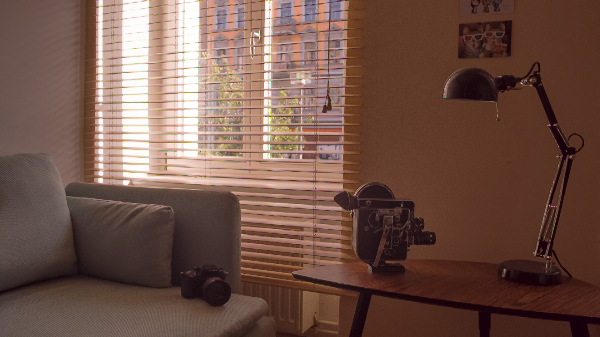

Administrators Andrew - EOSHD Posted July 17, 2013 Administrators Share Posted July 17, 2013 I've been testing this today and indeed the dynamic range is insane, proper Alexa league stuff. The problem is, I don't believe the image is usable yet. http://www.eoshd.com/uploads/5d3-hdrx.jpg Alex says he will optimise it but it needs very complex maths. The problem is, some sites out there have jumped on this like it is a free pass to 14 stops of DR. It isn't. That's what happens when the people writing the hype-articles never shoot or test anything with their own two hands before blogging it. :wacko: matt2491, JHines and fluxo 3 Link to comment Share on other sites More sharing options...
