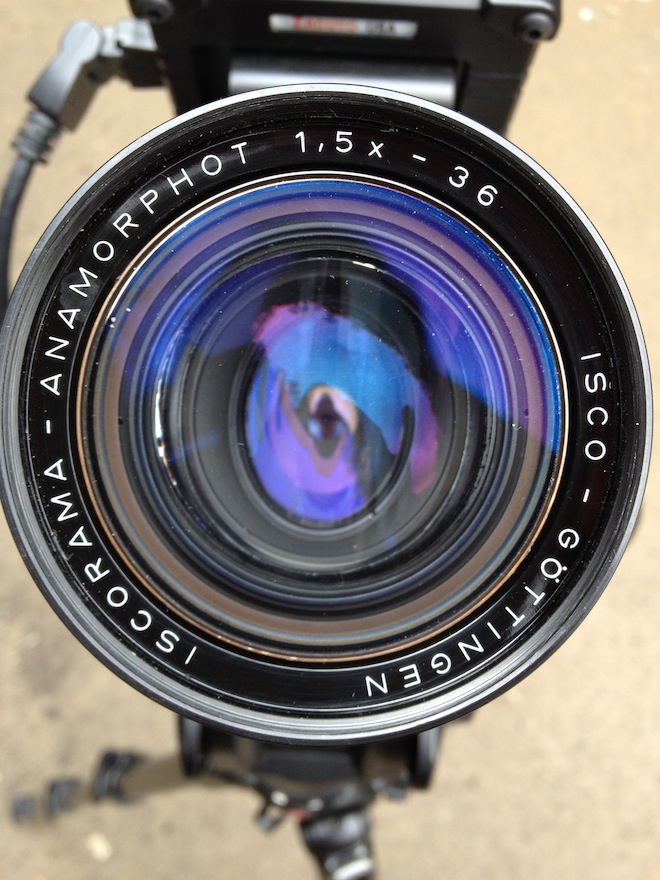

Giulio Dimitri Posted March 13, 2013 Share Posted March 13, 2013 Hello! maybe you already talked about this, but can't find where. What is the difference between this http://forum.mflenses.com/userpix/20099/455_ISCORAMA_M42_1.jpghttp://forum.mflenses.com/userpix/20099/455_ISCORAMA_M42_1.jpg and this http://www.eoshd.com/wp-content/uploads/2012/03/IMG_1496.jpg for instance, between the well known iscorama 36 (labeled iscorama - anamorphot - 1.5x - 36 - isco gottingen) and the iscorama (labeled iscorama - lens made in germany - serial number - isco gottingen) you can find in several mounts? thanks! Link to comment Share on other sites More sharing options...
Administrators Andrew - EOSHD Posted March 13, 2013 Administrators Share Posted March 13, 2013 First link broken. 2nd link shows my mutli-coated Iscorama 36. The original "Iscorama" has a smaller 30mm rear element instead of 36mm and came together with a Isco 50mm F2.8 taking lens in variety of mounts (i.e. M42, Nikon, etc.). It is single coated, not multi-coated. Flares nicely, and coverage is about the same despite the smaller rear element. Usable out to 24mm on the GH3, 30mm (2x crop) on the GH2 (1.86x crop), 35mm on APS-C and 50mm on full frame. Link to comment Share on other sites More sharing options...
Giulio Dimitri Posted March 13, 2013 Author Share Posted March 13, 2013 brilliant.Thanks Andrew. So, the "other iscorama" may be considered made out of the same quality of the iscorama 36.It is much easier to find though, i'm chasing one on ebay not cosmetically perfect and untested.hope it's not a piece of crap.What is the best way to couple it with a taking lens?redstan adapter, or a couple of spacers and a step down ring? Link to comment Share on other sites More sharing options...
richg101 Posted March 13, 2013 Share Posted March 13, 2013 I have one labelled 'iscorama - anamorphot - 1.5x - 36 - isco gottingen' on the front and it has a distinctly different front element colour to your above photo of Andrews isco36. Mine has a very faint amber coating, no blue or purple to be seen on mine. I have seen ones labelled like mine and the same as on image of Andrews, but with 'MC' added to the labelling. These had a blue coating like the above image. I wonder if Andrews has newer glass in an older body? Or they were using the older front printed rings without 'MC' on them during a transition from the manufacture of single and multi coated versions? I suppose being hand made in smaller numbers they will have been less continuity in parts used?? Link to comment Share on other sites More sharing options...
Administrators Andrew - EOSHD Posted March 13, 2013 Administrators Share Posted March 13, 2013 My belief is that when they switched to making the '36' as a stand-alone adapter, they added multi-coating. That is what gives it the blue/purple tint to the front element, whilst the older lenses have the amber tint from just a single coating. Later they added 'MC', but the first ones to have multi-coating were not labeled as having it, leading to some confusion now. I thought I was buying a single coated version because it lacked the 'MC' designation. So it goes something like this... 1968-69 - Iscorama, single coated 70-75 - Iscorama 36, multi-coated From some point in the 70's or 80's they added 'MC' lettering on the front of the lens Link to comment Share on other sites More sharing options...
