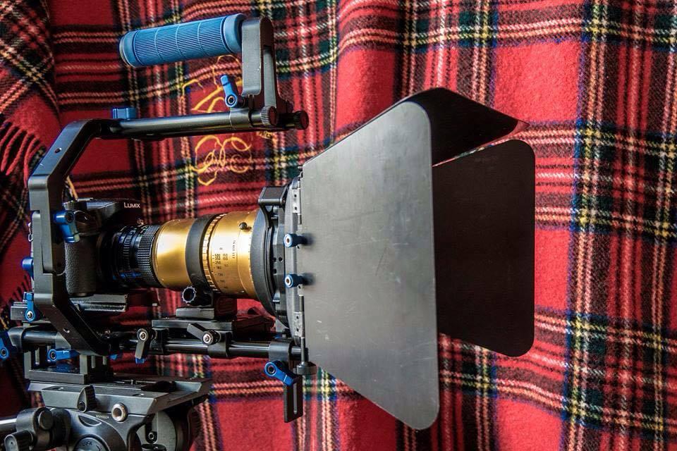

- I have a nice looking 15mm rail platform to operate on (although it's a bit heavy for my tripod sometimes, as you'll notice in the film):
12071608_10156140192385387_989823897_n.t
It also has a nice Mattebox system for all my filter needs!
it's really encouraging to see that I'm not getting too shunned from using a projection lens; but hey! I'm working on a budget! So thanks a lot for all the great tips, Bold, I'll make sure to print out goodies (like focus sheets) to put me on the right track.
Yep, weight is often a drawback when using projection lenses. But the setup looks good!
